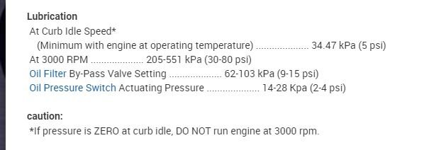

This could be a bad oil pressure sensor, or the oil pressure may actually be low from engine wear.
https://www.2carpros.com/articles/high-or-low-engine-oil-pressure

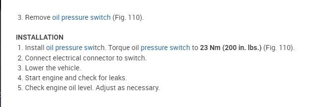

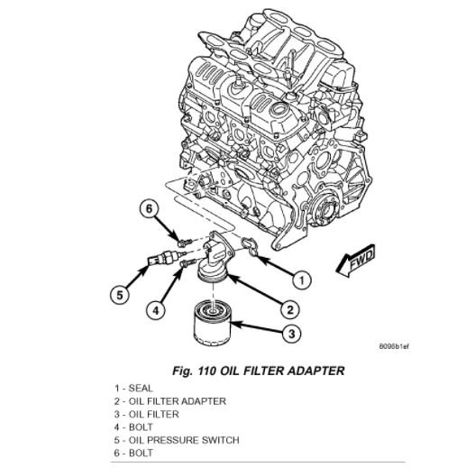

I would remove the sender and use a manual tester to test the actual pressure.
I attached the specs below for you to view. You can rent the tester at a parts store.
