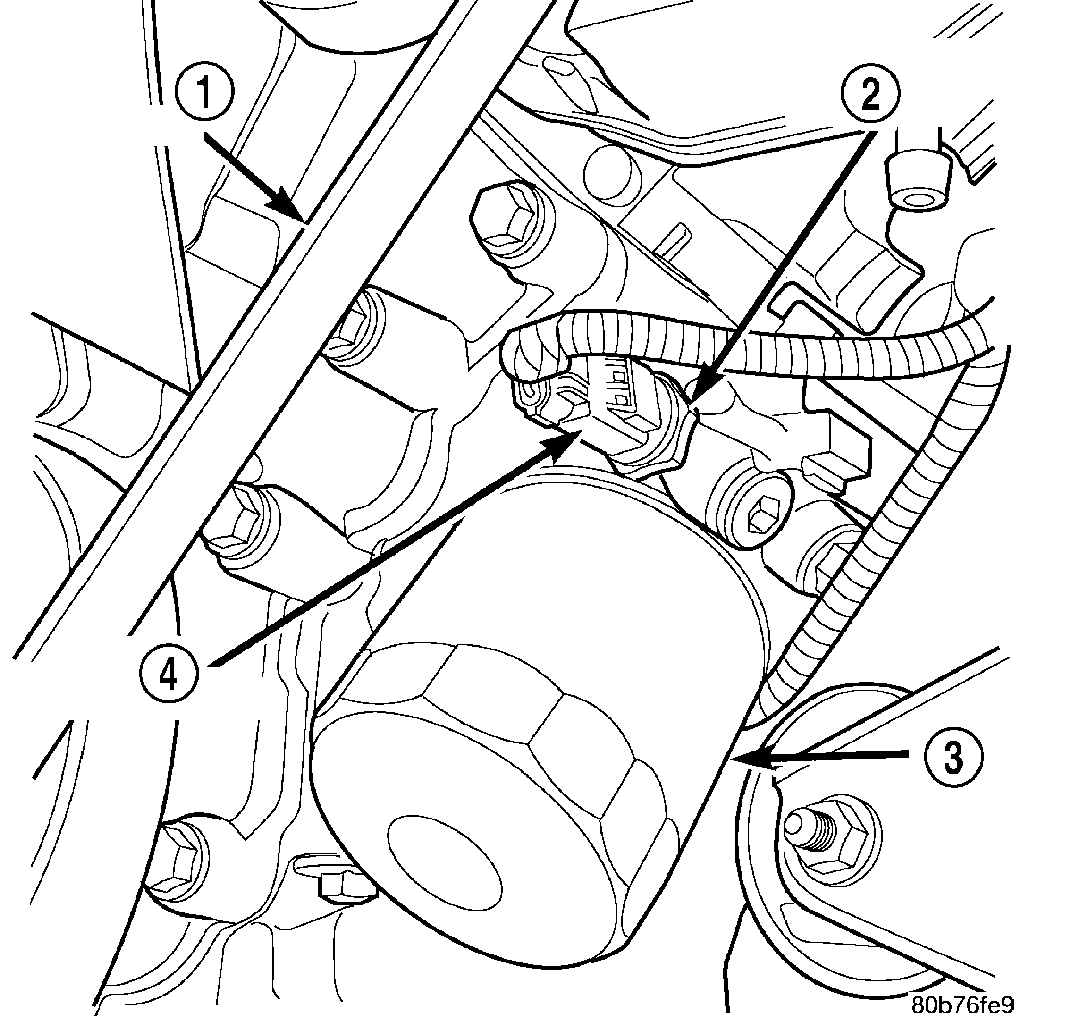

My oil light comes on when I stop at a stop sign and goes off when I go again. Replaced valve cover gaskets, heads, and pressure sensor. Please help

Because of the mileage, I recommend that you check oil pressure with a mechanical oil pressure gauge. Most parts stores will lend or rent the gauge to you. All you do is remove the electric oil sending unit and screw the mechanical one in its place. Once you start the engine, you will see how much pressure you have at idle.
Now, if you are not hearing any ticking or knocking when the light is on, that is a good thing. However, we need to confirm it isn't truly a pressure issue.
Here are the manufacturer's specs for minimum pressure requirements before the light turns on and at 2500 rpm's

One last thing, make sure the sensor you replaced is the one next to the oil filter and there are no leaks. Also, make sure the oil is clean and full and you have a good quality oil filter installed.

Okay, that's the sensor I replaced and I don't see any leaks anywhere.
