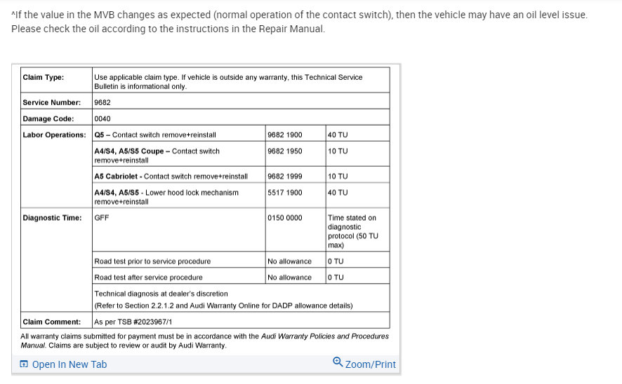

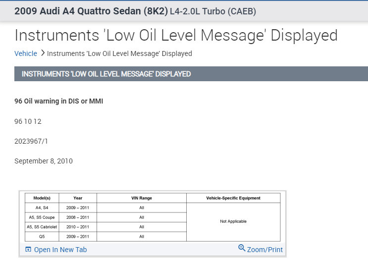

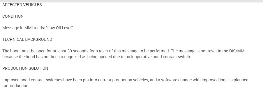

Believe it or not, there is a technical service bulletin. It is related to the hood sensor. The hood has to be open for at least 30 seconds for the light to reset. There is an issue with the sensor that isn't recognizing that.
If you look at the attachments below, it is the actual TSB. Take a look through it and let me know if it helps.

According to the TSB, the hood switch doesn't indicate the hood is open. When you open the hood and have the key on, does it indicate the hood is ajar?

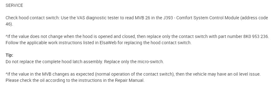

Okay, that sounds like everything is working correctly, but if the oil isn't low, that still seems to be the prime suspect. Additionally, the manual indicates you have to test the hood switch with a VAG tester. See the directions below.
Check hood contact switch: Use the VAS diagnostic tester to read MVB 26 in the J393 - Comfort System Control Module (address code 46).
If the value does not change when the hood is opened and closed, then replace only the contact switch with part number 8K0 953 236. Follow the applicable work instructions listed in ElsaWeb for replacing the hood contact switch.
Tip:
Do not replace the complete hood latch assembly. Replace only the micro-switch.

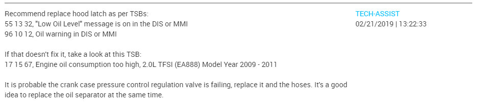

PS: I came across something that may be of interest to you. See the attachment below. This is from a tech site, so you may want to check things.
