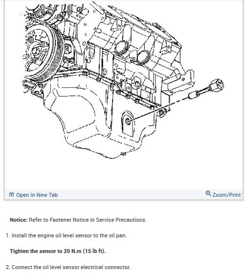

I have taken it to two shops and they put it on the scope changed the sensor which they said it was bad charged me $150.00 + each time. Next time it is cool and started same issue?

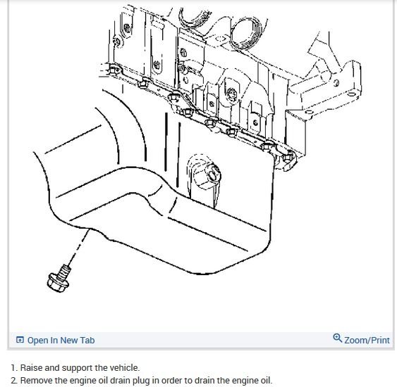

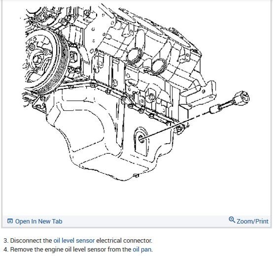

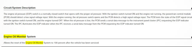

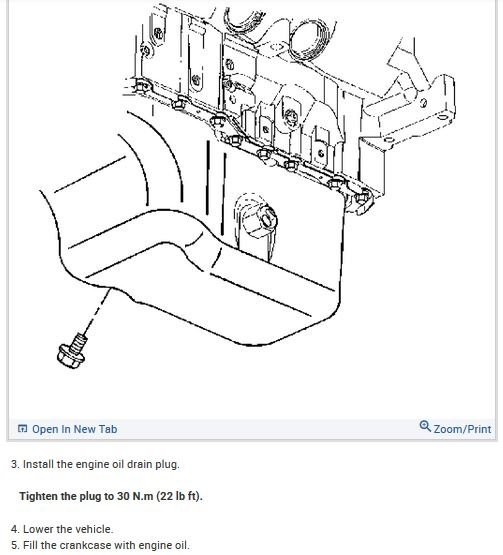

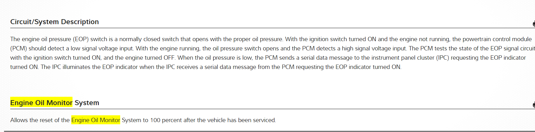

This could simply be a low oil situation. I would double check my engine oil and make sure it is reading correctly on the dipstick. I have included a circuit description for you in the diagrams below. Please read it and get back to us with what you find out.
