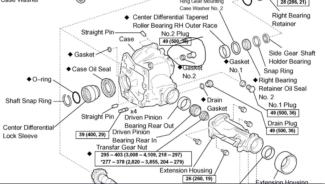

Oil leaking from the vent in the transfer case
2005 TOYOTA SIENNA
215,000 MILES • 3.3L • 4 CYL • 4WD • AUTOMATIC
MYKOLA BURDA
I understood that the transfer case is fully filled up with oil that comes from the transmission but does not come back to the transmission by itself with no force applied like I think it's supposed to.

Good evening,
There is a TSB on this issue from a failed seal.
It is covered under warranty from the dealer for this issue.
T-SB-0138-10
Rev1
May 28, 2010
Transmission Fluid or Gear Oil Seepage from Transfer
Case Vent (AWD)

Some 2004 - 2009 model year Highlander 2001 - 2005 model year RAV4 and 2004 - 2010 model year Sienna AWD (4WD) vehicles may display a transmission fluid or gear oil seepage from a vent on the right side of the transfer case. The seepage is from the transfer RH (right-hand) bearing retainer No.2 oil seal. Production improvements have been implemented to prevent this condition from occurring. Follow the repair procedure in this bulletin to replace the RH bearing retainer No.2 oil seal assembly.

This repair is covered under the Toyota Powertrain Warranty. This warranty is in effect for 60 months or 60,000 miles, whichever occurs first, from the vehicle's in-service date.

I am not that of an expert so can you please try to explain the answer to me in your own words please ? Thank you.
If you forgot my issue was: I understood that the transfer case is fully filled up with oil that comes from the transmission but does not come back to the transmission by itself with no force applied like I think it's supposed to.

There is a bearing or seal in the transfer case that is causing the issue. It is covered under warranty for you.
