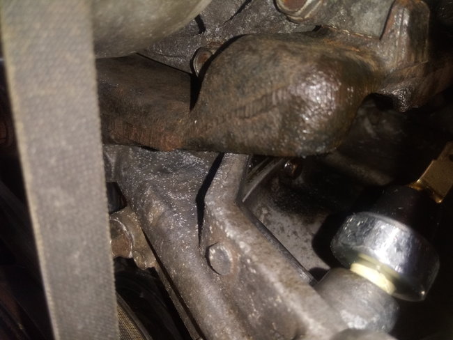

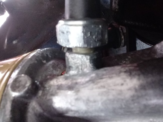

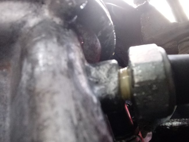

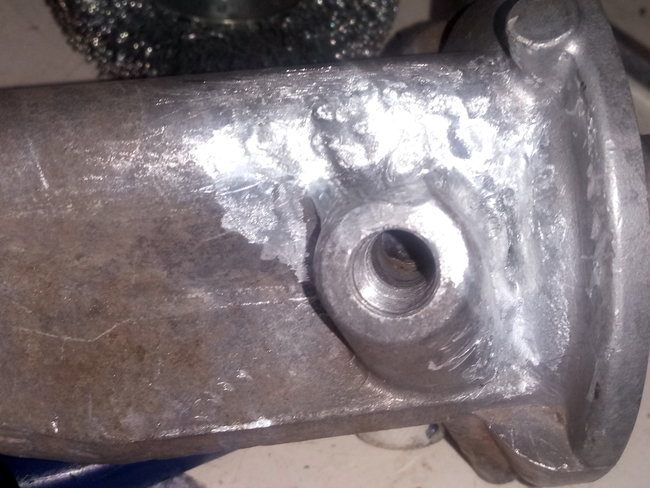

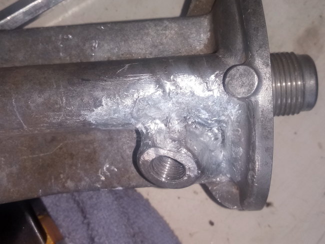

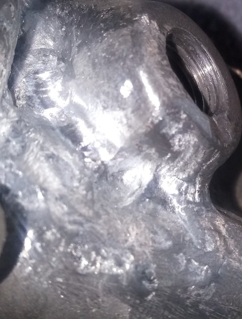

So bought this vehicle listed above, and was given a new OPS and told that's what was causing check engine light but they didn't have time to replace. I went to replace it,and find out that whomever, had cracked the oil filter bracket by over tightening I ripped front of engine off and removed bracket, it is next to impossible to find them anymore. so welded the crack and put back in, weld is beautiful, but I believe there is a spiral leak from thread damaged when crack was made. Need a fix to seal it, at this point I don't care if fix means it can never be removed again. Just need my car back on the road.. Thank you.

Good morning,
Can you post some pictures of this for me to view?

Here's some pictures after the weld was finished before it went back in. I'll take some of the situation now as soon as I can get outside here.
Apr 1, 2020 at 1:39 AM
Please resubmit and attach it to this post.
Apr 1, 2020 at 1:43 AM
DEVIN7414
  • 6 POSTS
Here tried again.
Apr 1, 2020 at 1:51 AM
I agree. It looks like the threads are gone. There will be no re tapping of this since there is nothing to clean up.
I think you need to go to a junkyard and look for a replacement.

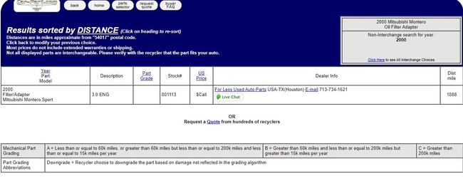

Ya, there's not one within 100 miles of me.

Found one. I posted it below for you with contact information. Give them a call.

Thank you. does it matter that, that is a 3.0 and mine is 3.5?
Apr 1, 2020 at 4:33 AM
I would call them and ask them. I cannot find the part number for it but the motors are physically the same.
