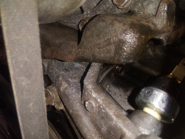

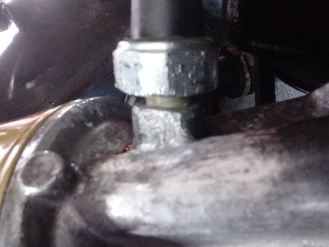

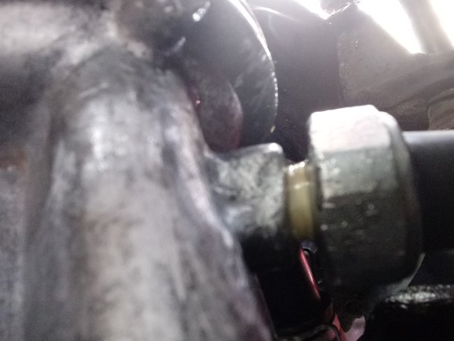

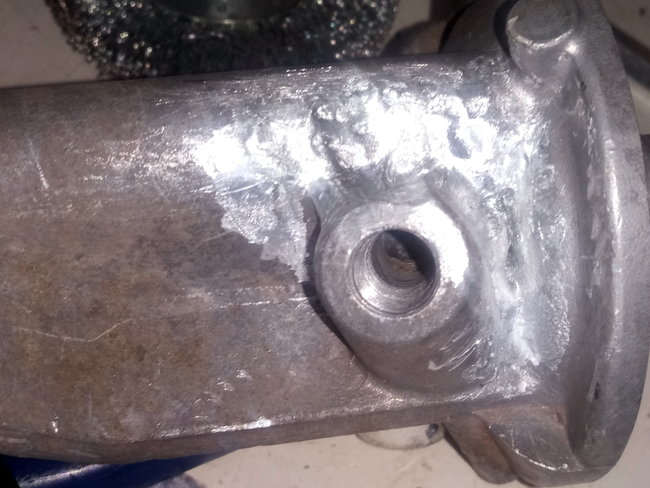

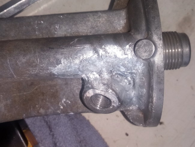

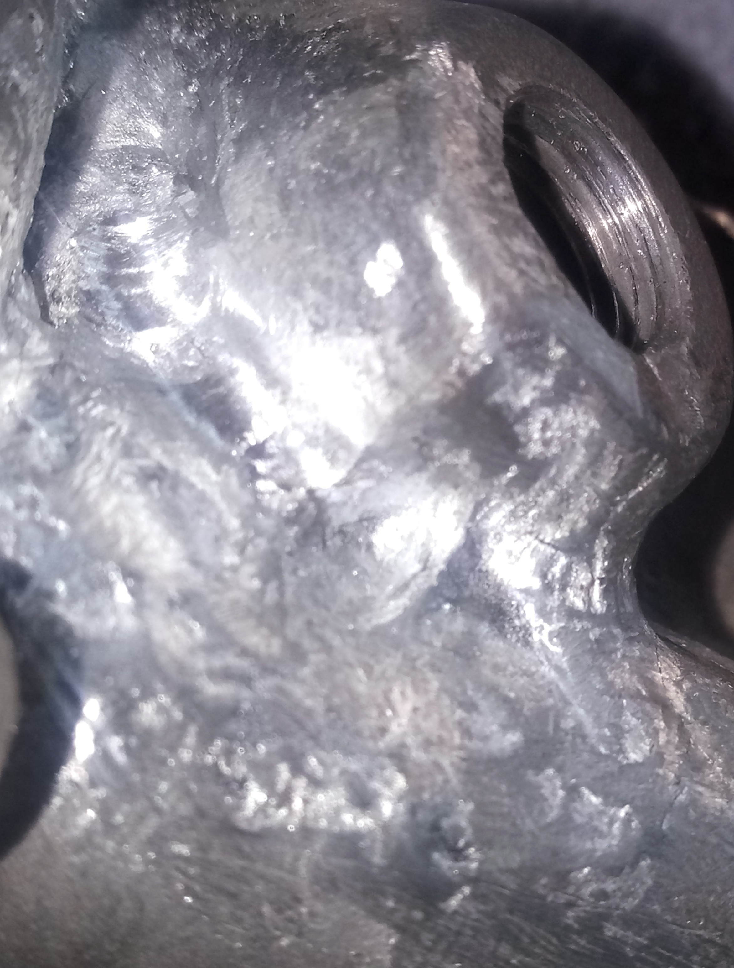

So bought this vehicle listed above, and was given a new OPS and told that's what was causing check engine light but they didn't have time to replace. I went to replace it,and find out that whomever, had cracked the oil filter bracket by over tightening I ripped front of engine off and removed bracket, it is next to impossible to find them anymore. so welded the crack and put back in, weld is beautiful, but I believe there is a spiral leak from thread damaged when crack was made. Need a fix to seal it, at this point I don't care if fix means it can never be removed again. Just need my car back on the road.. Thank you.

DEVIN7414
  • 6 POSTS
Here's some pictures after the weld was finished before it went back in. I'll take some of the situation now as soon as I can get outside here.

Please resubmit and attach it to this post.

DEVIN7414
  • 6 POSTS
Here tried again.
Apr 1, 2020 at 1:51 AM
I agree. It looks like the threads are gone. There will be no re tapping of this since there is nothing to clean up.
I think you need to go to a junkyard and look for a replacement.

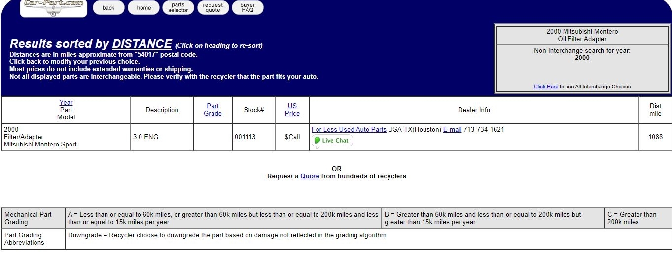

DEVIN7414
  • 6 POSTS

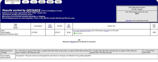

Ya, there's not one within 100 miles of me.
Apr 1, 2020 at 2:46 AM
What is your zip code?
Apr 1, 2020 at 2:50 AM
DEVIN7414
  • 6 POSTS
54017 New Richmond, WI.
Apr 1, 2020 at 3:39 AM
Found one. I posted it below for you with contact information. Give them a call.
Apr 1, 2020 at 3:48 AM
DEVIN7414
  • 6 POSTS
Thank you. does it matter that, that is a 3.0 and mine is 3.5?
Apr 1, 2020 at 4:33 AM
I would call them and ask them. I cannot find the part number for it but the motors are physically the same.
