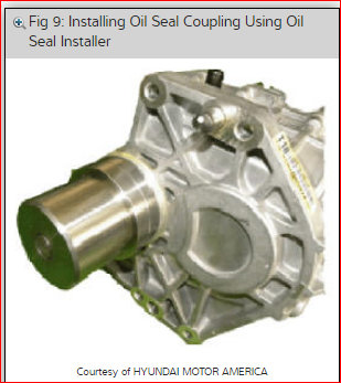

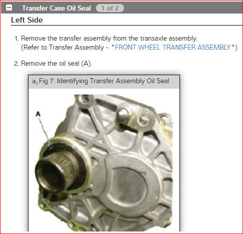

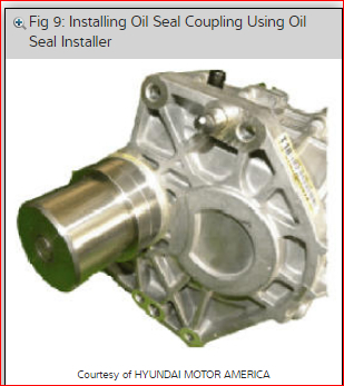

but my case similarly in this site. (leak from inner oil seal)
https://www.brakeandfrontend.com/tech-tip-hyundai-automatic-transaxle-oil-leak-between-transaxle-and-transfer-case/
Jan 7, 2019 at 2:47 AM

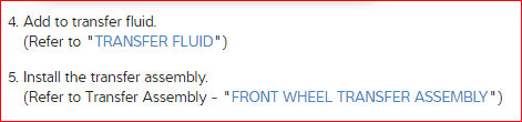

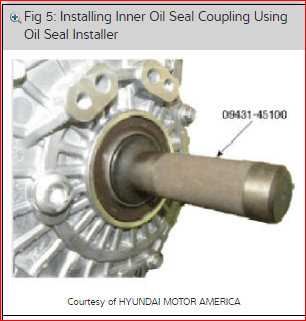

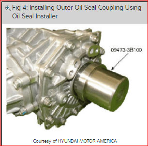

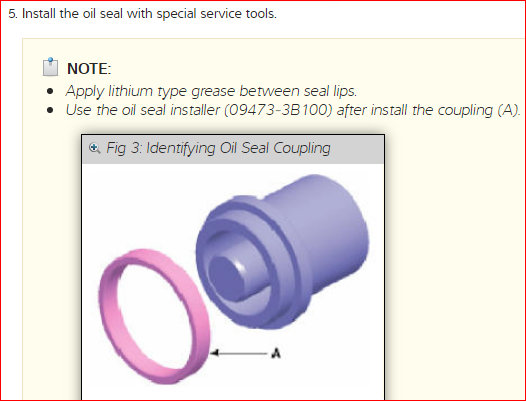

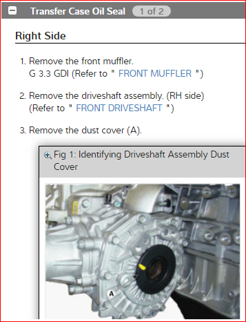

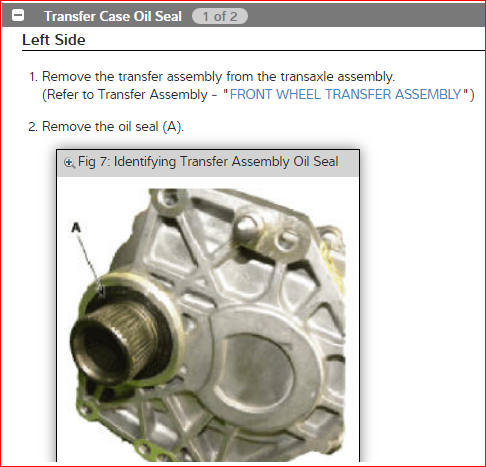

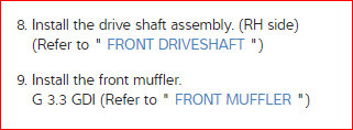

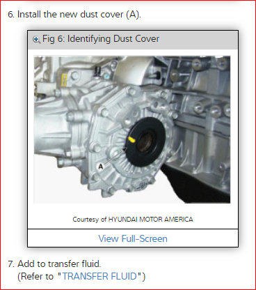

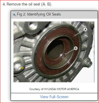

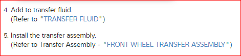

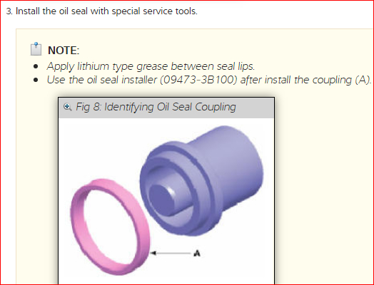

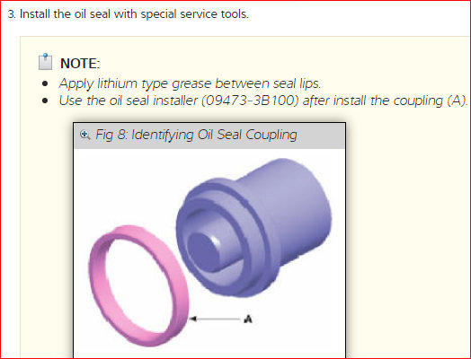

DANNY L
  • 5,648 POSTS
Hello again.

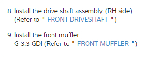

Those look to be good detailed instructions on the link you've provided. I would go with those too. I've attached step-by step instructions below that are similar.Hope this helps and thanks again for using 2CarPros.
