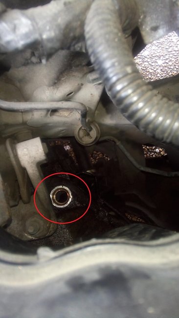

I am seeing some oil leak in this area in the top left corner and I am not sure what is supposed to be there. If you are able, please provide me with a diagram or the name of this opening.
Thanks

That appears like the transmission dipstick is missing. Take a look at the attachments. You will need to check the fluid after you get a replacement cap/dipstick so just make sure you use the recommended fluid.
I believe I attached everything you will need. Let me know if you have questions. Thanks
