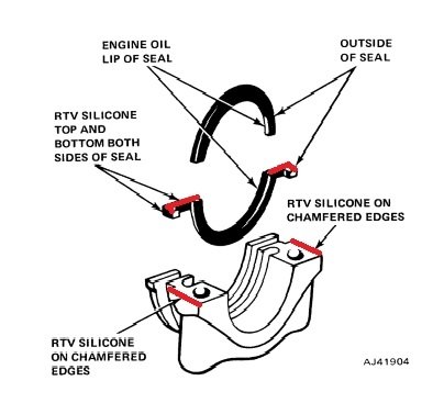

I have an oil leak in the rear between the back of the block and the bell housing. I replaced the rear main seal thinking that was the problem but it is still leaking. I took it to a mechanic shop to have them look at it and they said it was the rear main as well so they replaced it. however, it is still leaking down between the bell housing and the back of the block. They said that it is not the rear main. Any thoughts?

I uploaded a 258 diagram of its rear main (below).
When I have these apart I use brake cleaner to get all the oil off of the rear main cap and the opposing part of the block.
I lube my upper half and install it.
I brake clean the mating tips (so they are oil free) that showing and let them dry.
This will let the bottom half's silicone adhere better to the top half.
I install my bottom half of the seal and lube the lip only, being careful not to get oil where my silicone must seal. I silicone the chamfered edges of the rear cap's sides. This keeps oil from weeping out of the little hole/ crack that forms in the corners when the cap is seated in the block.
I "painted" the silicone portions in red in my diagram.
