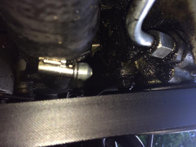

Oil leak behind power steering wheel and fanbelt
2003 FORD FALCON
141,868 MILES • 4.0L • 6 CYL • RWD • AUTOMATIC
PAIGEN97
I have an oil leak which is being caused behind my power steering wheel on my fanbelt and under my power steering fluid. It is producing a thick funky black oily substance going everywhere. It is leaking into the ground pretty badly but just can think of what it could be.

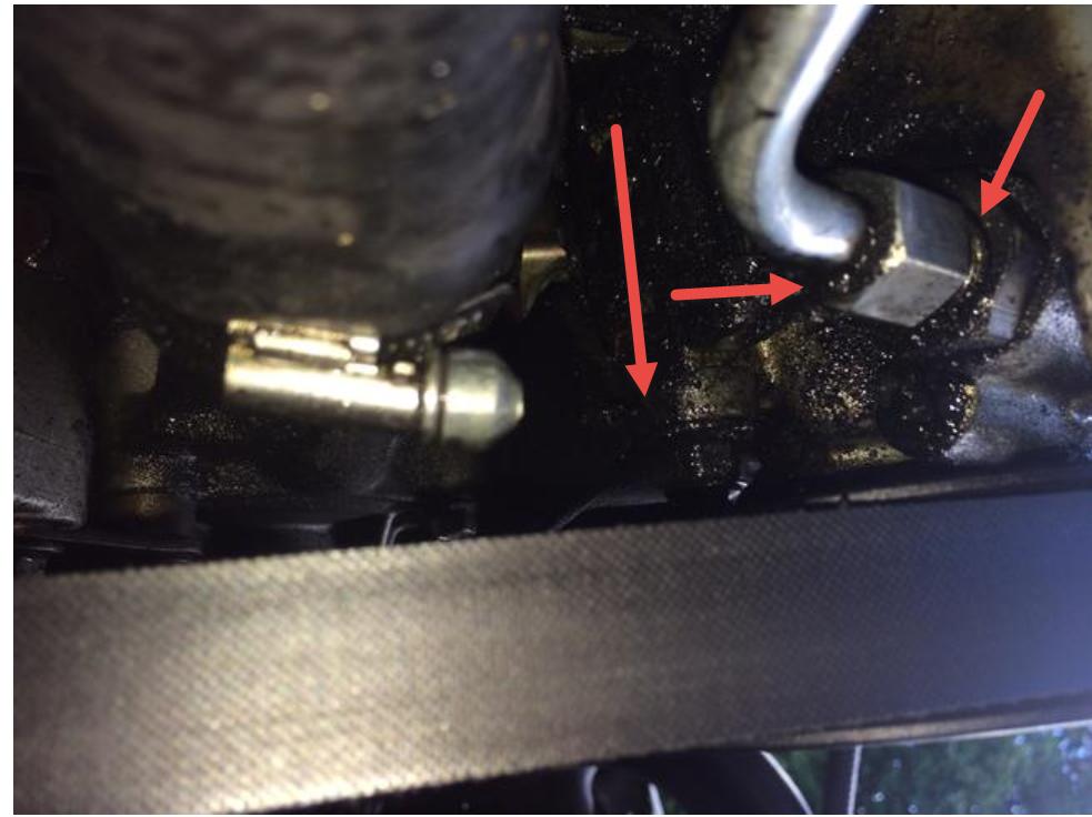

we dont' have that in US but check line for being tight and o rings where arrows are pointing on body
