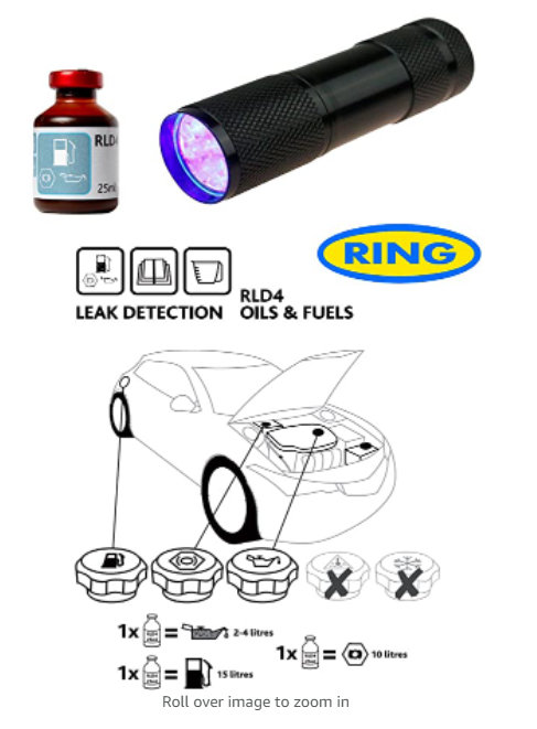

It is worthwhile checking if the previous valve cover leaks did not cause the exhaust/turbo heat shield to absorb a good amount of oil. This is then released as the heatshield heats up.
An easy test would be to remove the heat shield, clean it, and then hold it over a source of high heat, such as a gas stove. Hold it there for a while to become really hot and then check if any oil oozes out
Another test would be to add some leak dye into the engine oil, clean the oil leaks and surrounding area. drive the vehicle until oil is found to be leaking again and then check using a UV light if there is any dye in the oil, indicating a fresh leak from the engine.
See picture below, this kit is available from Amazon and other retailers
Another reason for engine oil leaks could be a malfunctioning PCV valve. This should have been replaced together with the new valve cover.
