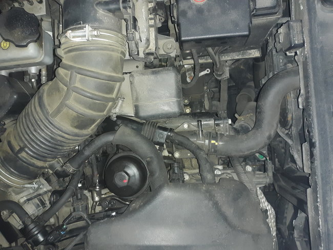

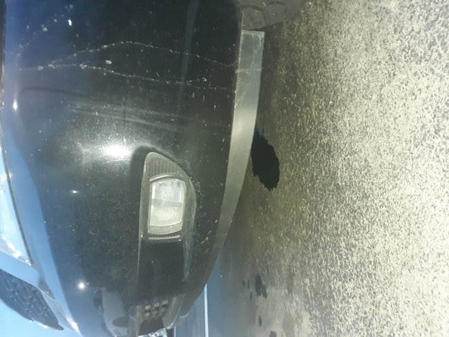

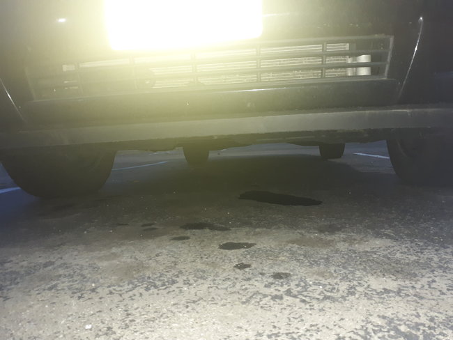

Pictures of leak that I could get. The big puddle is the leak.
Dec 12, 2019 at 7:17 AM
Thanks. Make sure the oil filter cover is not leaking. The seal may not be seated correctly.
