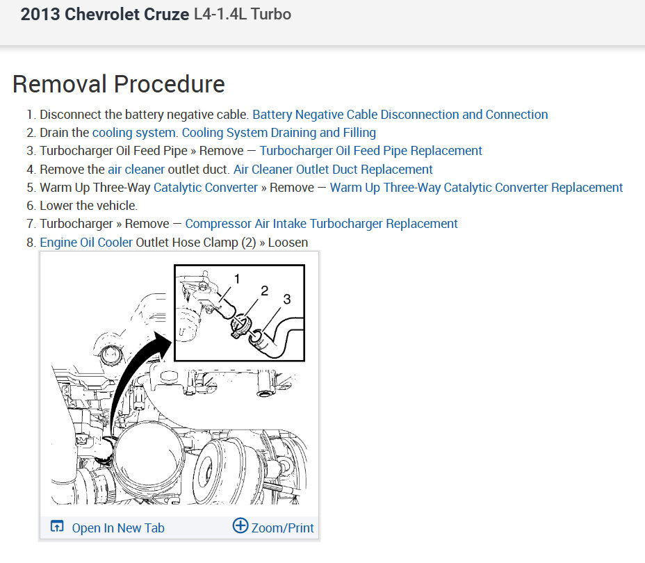

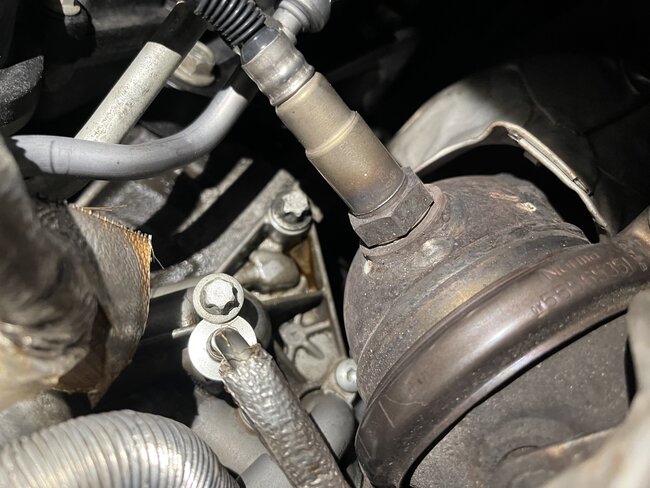

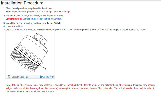

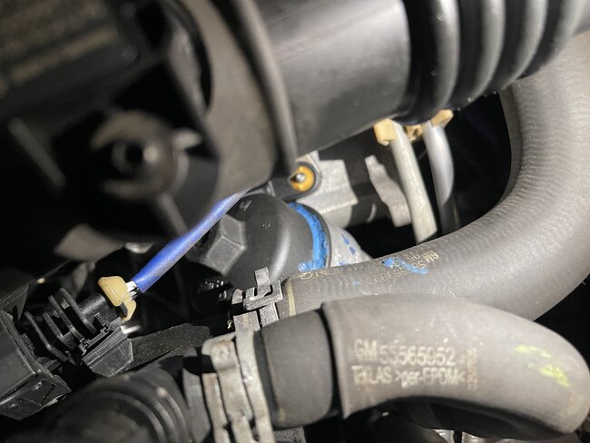

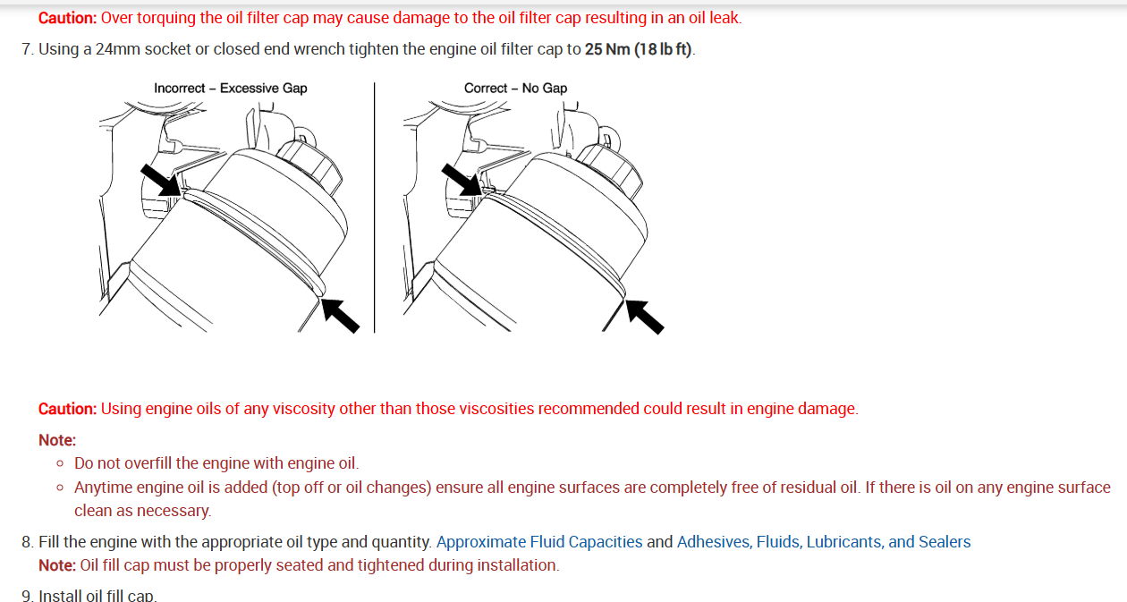

I never had one of those, so I bought one. I saw some oil smoke which after I washed the motor, I saw some left-over oil smoke because it was one the exhaust. I guess it was leaking from somewhere which I believe could be the oil filter housing, is this something common on these cars to leak? I attached pictures for you to see.
Nov 23, 2024 at 7:35 AM
  • 55,433 POSTS

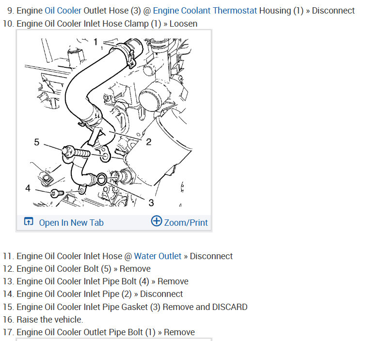

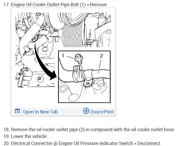

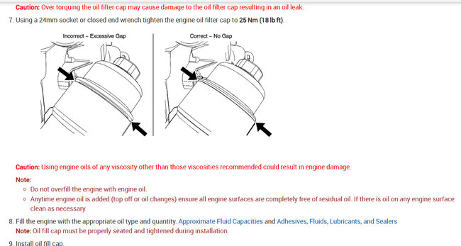

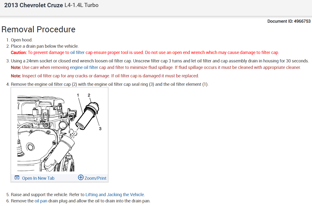

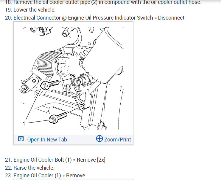

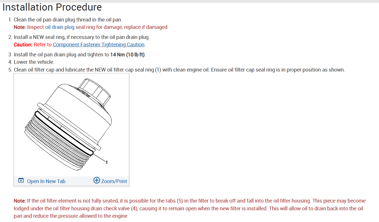

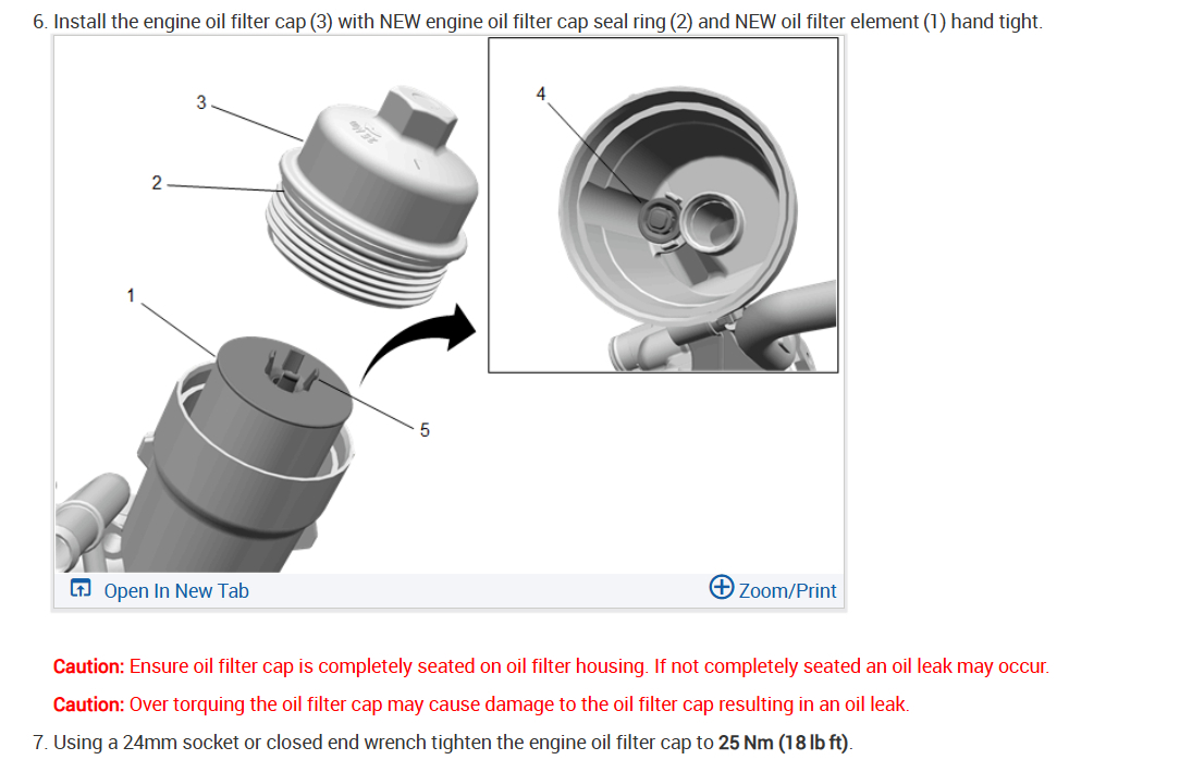

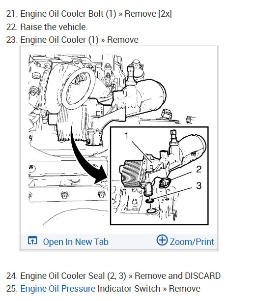

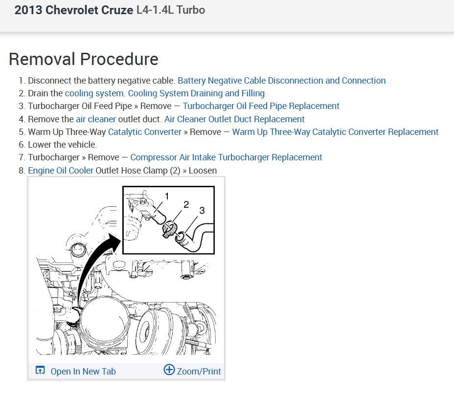

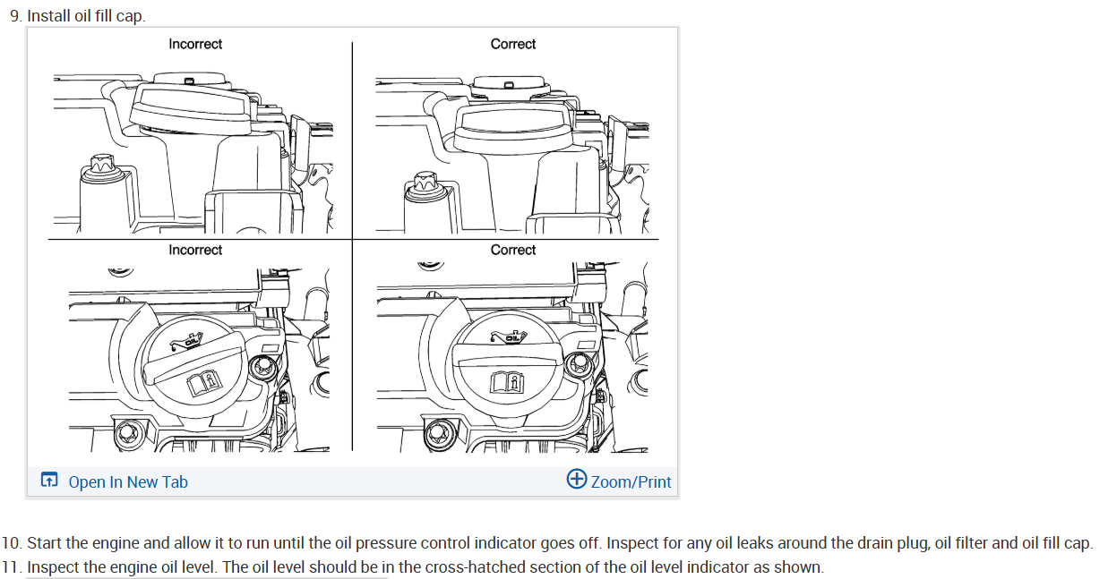

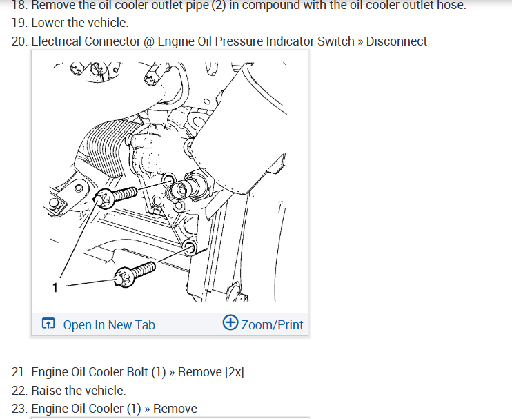

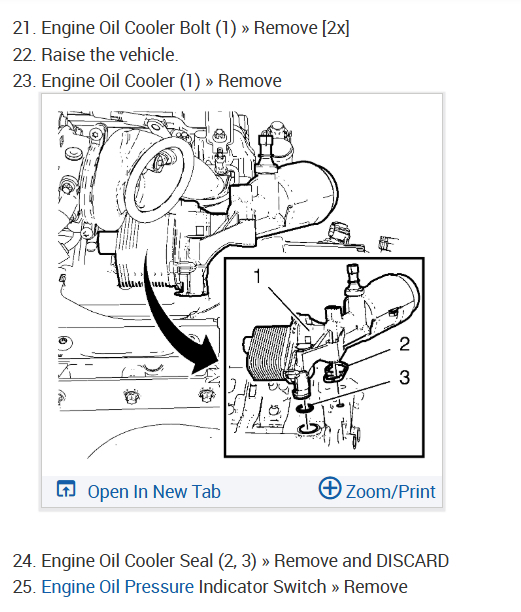

Yes, this is very common to have the oil filter housing/cooler to leak from the canister seal and the gaskets. Here is the correct way to install the engine oil filter and the engine oil cooler. Check out the images (below). Please upload pictures or videos in your response of any problems so we can see what to help you with.

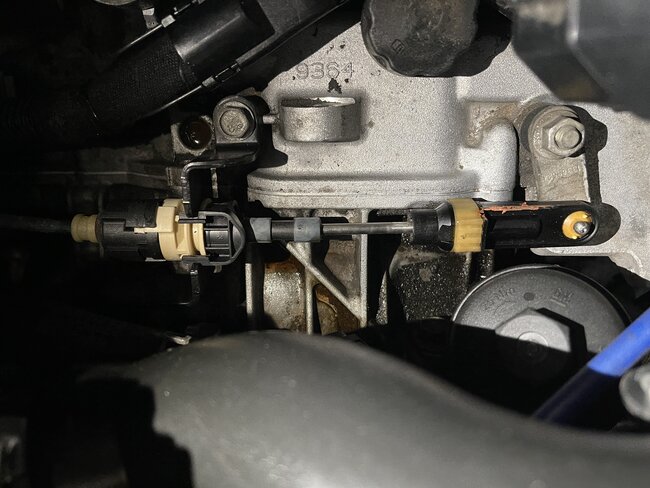

They had to place it behind the turbo and exhaust manifold.
Nov 24, 2024 at 3:36 AM
  • 55,433 POSTS
Yep, bad spot for sure, let me know what you find.

What is the torque spec for bolts to the oil filter housing/oil cooler?
Nov 25, 2024 at 9:06 PM
  • 55,433 POSTS
They only give the the torque specs in the instructions.
Nov 26, 2024 at 2:54 AM
BHAMDOC1973
  • 2,007 POSTS
It's not in any of the pictures.
Nov 26, 2024 at 2:58 AM
  • 55,433 POSTS
That's all they give us you can see for yourself.
