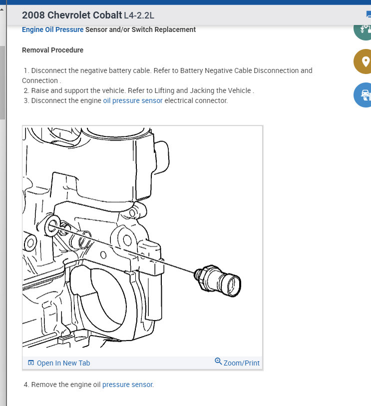

I checked my dip stick and was halfway. Til I saw oil spot in the driveway front driver side. Wiped up excess oil underbody and looked for heavy saturated areas found a electrical plug heavy coated Don't know if that's the sending unit where leak is coming from to the left of the oil filter. it's dark now can take a picture in the morning.

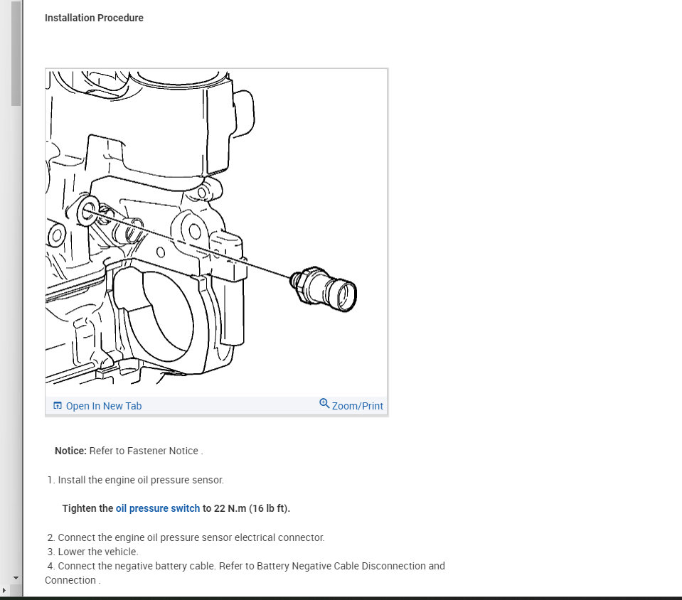

A picture will help. However, this could be the oil pressure sender.
I am attaching info on this below to see if this is where you are seeing this oil coming from.
However, what we need to do is clean everything off and then add an oil dye to the oil and that will help us find where this is coming from.

Please see the info attached of the sender and let us know if you can get that picture and we can go from there.
