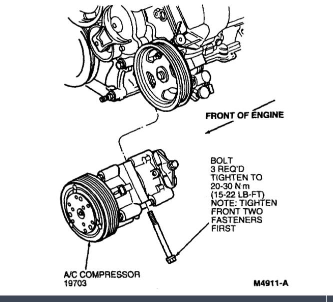

oil leaking from behind the A/C compressor.
Feb 23, 2021 at 4:54 PM
Good afternoon,

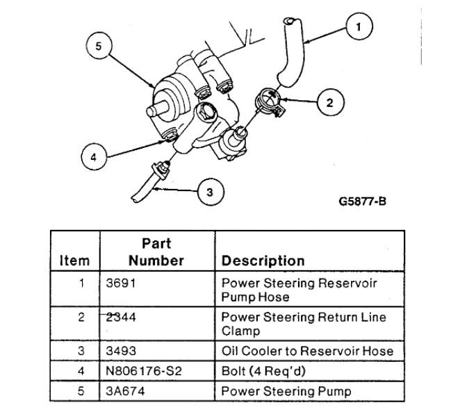

This sounds like the power steering pump may be leaking.
https://www.2carpros.com/articles/engine-is-leaking-oil
I would clean the area of all oil and run it for a day to confirm.
https://www.2carpros.com/articles/how-to-replace-a-power-steering-pump

10. Remove A/C manifold and tube and A/C compressor.
11. Disconnect power steering pressure hose and power steering reservoir pump hose from power steering pump.
12. Remove four bolts retaining power steering pump to engine.
13. Remove power steering pump from vehicle.

3. Install power steering pressure hose to the power steering pump. Tighten tube nut with a flare nut crows foot wrench. Use care not to damage power steering pump pulley. Tighten tube nut to 41-54 Nm (31-39 ft. lbs.). Swivel or end play of the power steering pressure hose tube end is normal and does not indicate a loose fitting.
4. Install power steering reservoir pump hose to power steering pump. Reposition power steering return line clamp.
5. Install A/C compressor and A/C manifold and tube. Install five push pins and three screws retaining lower radiator air deflector.
