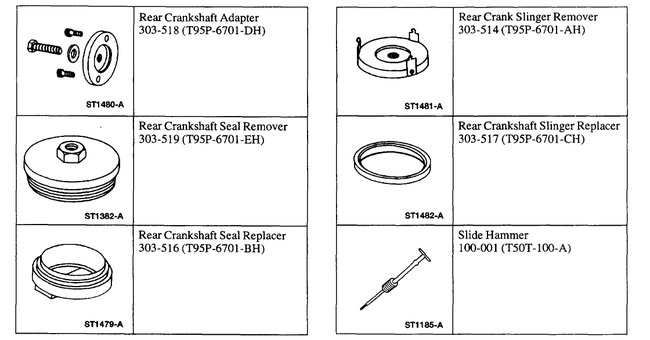

Not real fun but not the worst item. Basically you drop the transmission out. Remove the flex plate and remove and replace the seal. While you have the transmission out it is a good idea to change the input and output shaft seals.
The special tools do make the job easier if you can borrow them. Some parts places have them as loaner tools.

Here is a guide and a video to help you see what you are in for when doing the job.
https://www.2carpros.com/articles/crankshaft-main-seal-replacement-rear
and this video shows the job but your will be a truck.
https://youtu.be/JpzefqEeVGE
