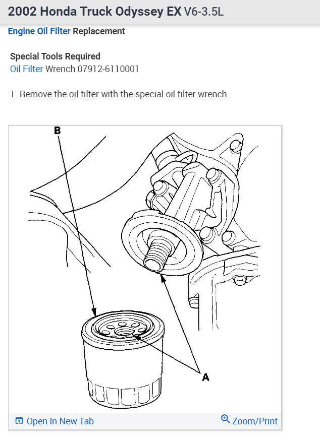

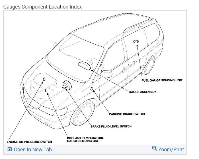

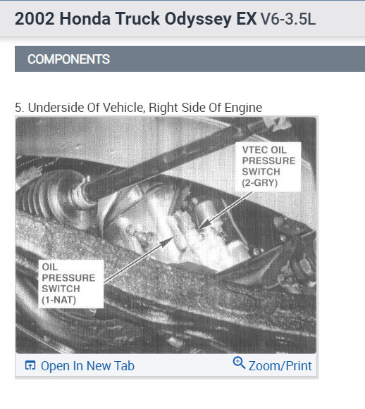

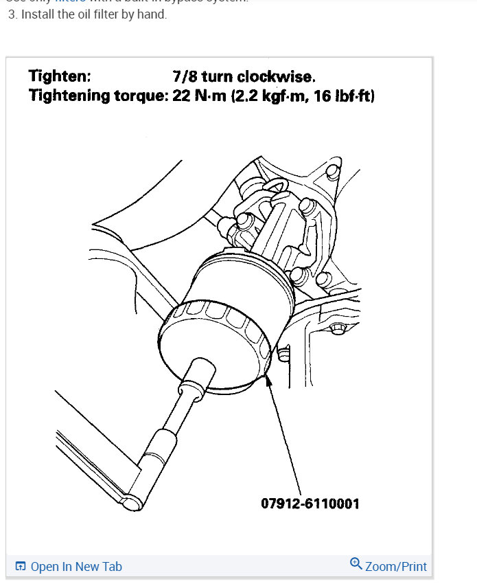

Have an oil leak, not sure where it is yet, but it's on the oil pan. The previous owner had the oil pan replaced, so I don't think it's that. what are other common places these vehicles leak besides valve cover?
Jul 15, 2023 at 2:17 AM
  • 55,456 POSTS
Common places I would check are the oil filter gasket or the filter could be loose. Next would be the oil pressure sensor. I would check the oil pan drain plug as well.
Here is a guide that can help:
https://www.2carpros.com/articles/engine-is-leaking-oil
Use this guide to raise the car up and check for the leak with a flashlight:
Please check out the images below to see what I am talking about. Check out the images (below). Let us know what happens and please upload pictures or videos of the problem so we can see what's going on.
