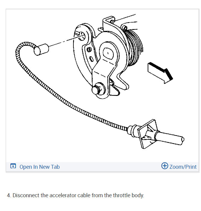

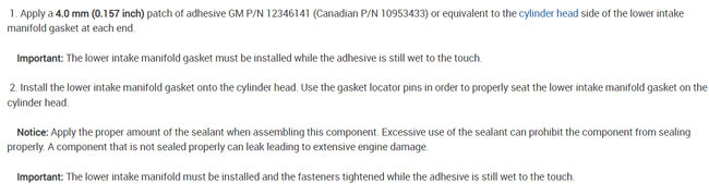

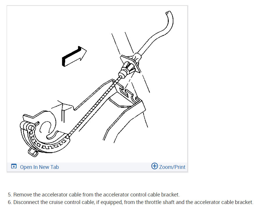

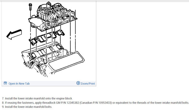

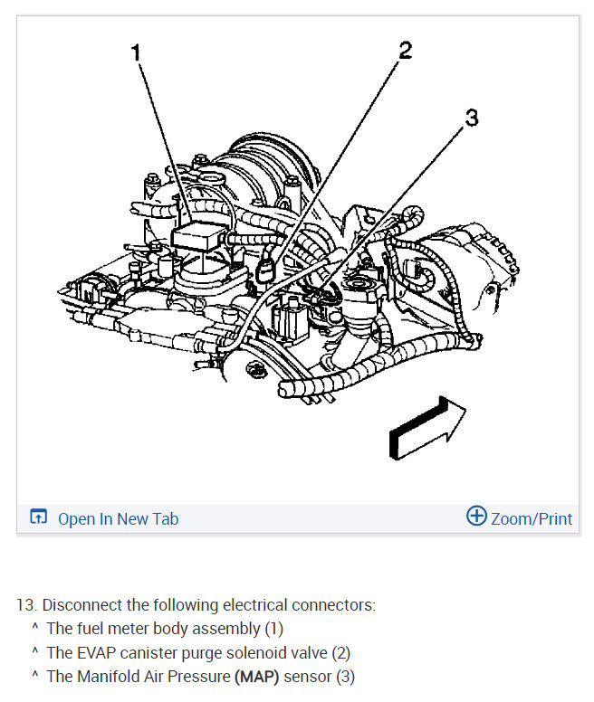

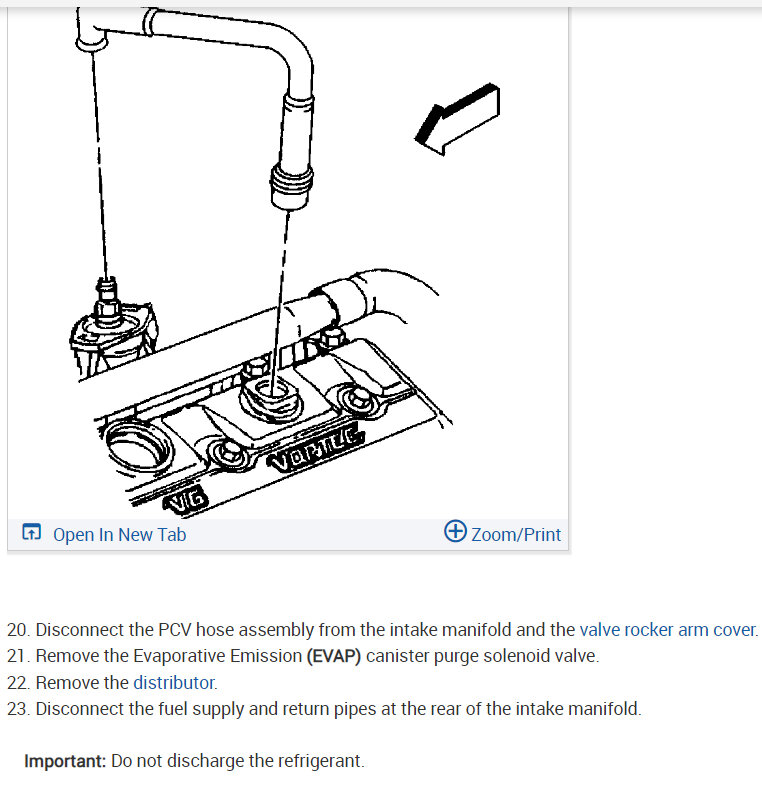

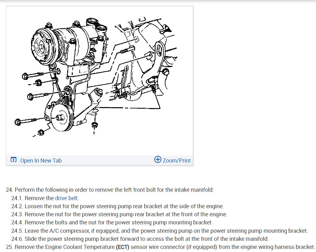

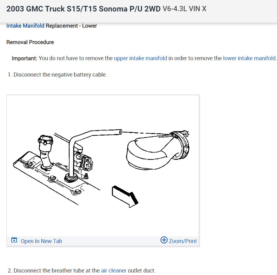

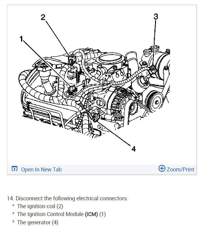

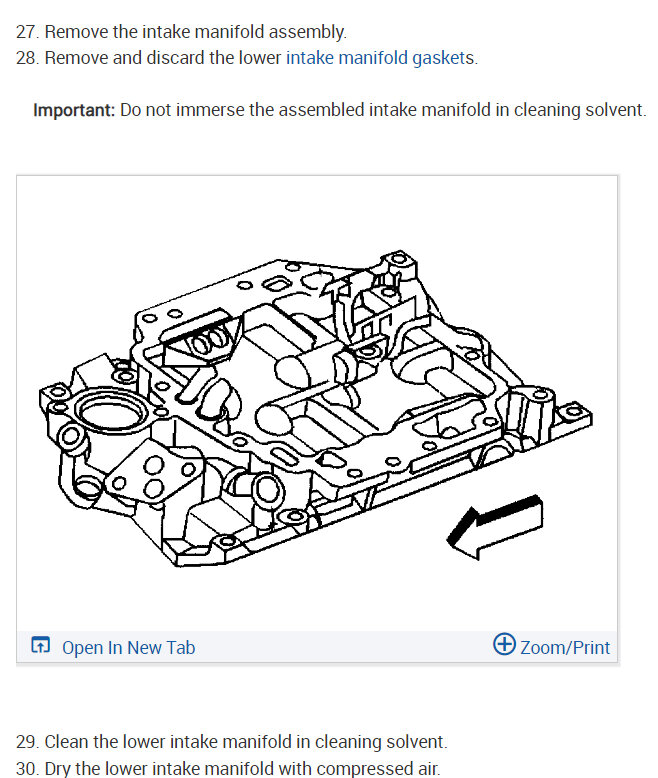

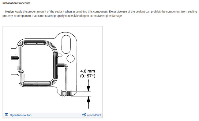

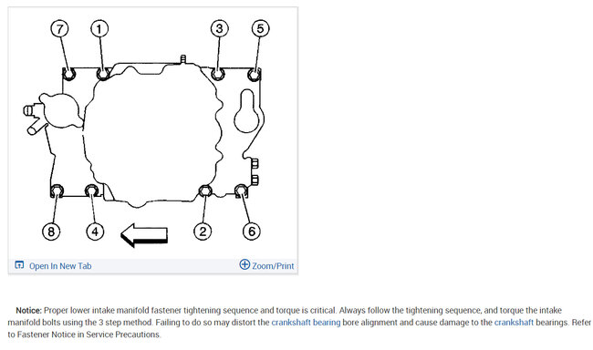

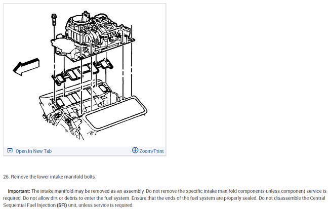

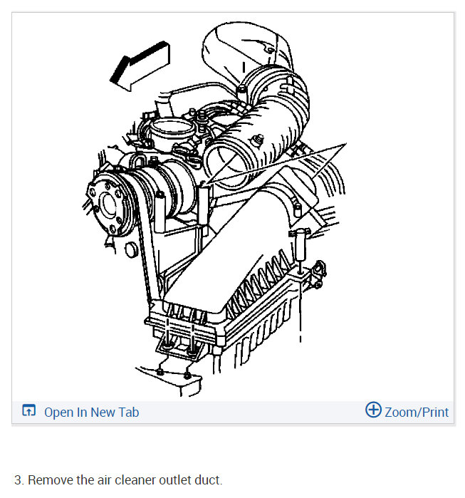

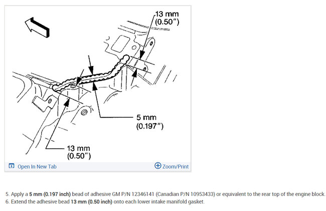

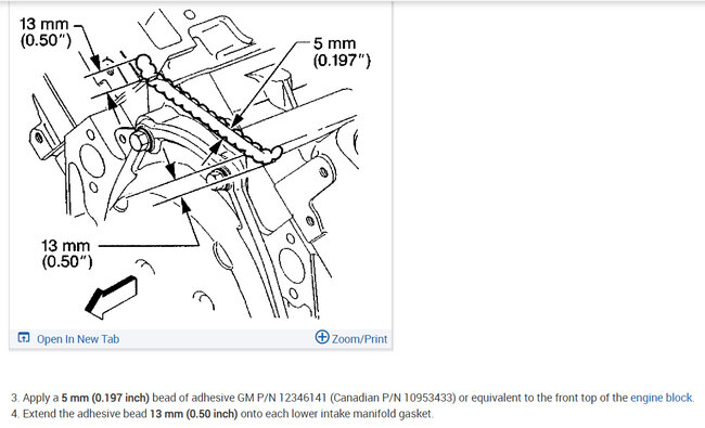

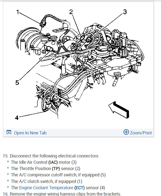

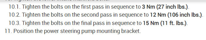

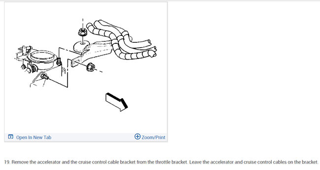

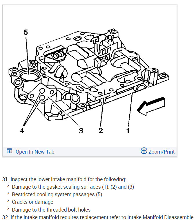

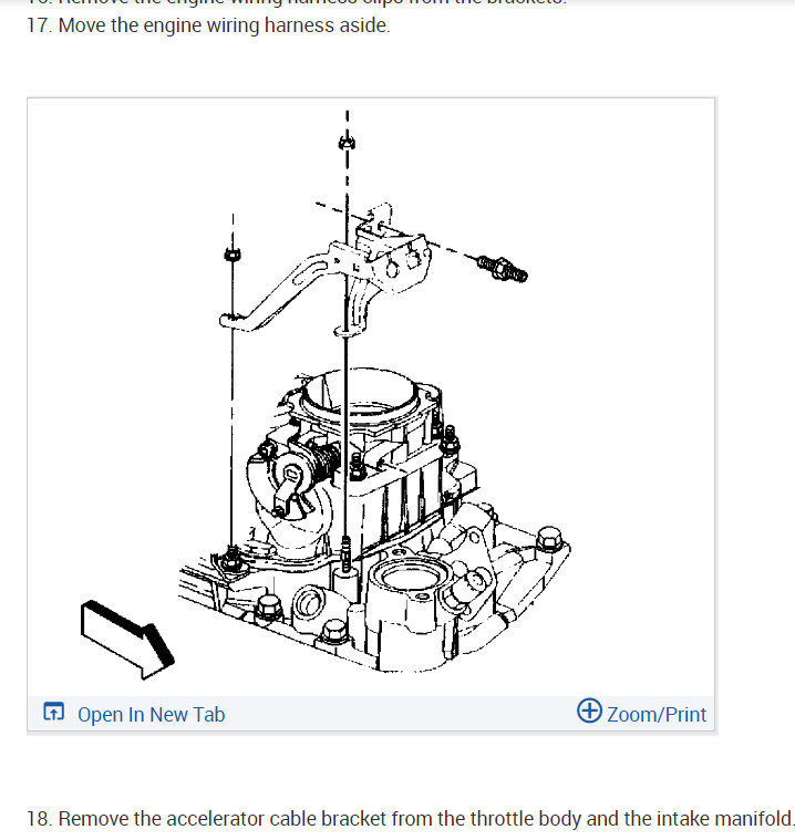

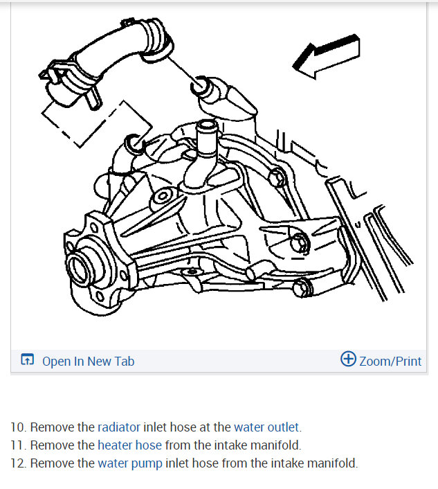

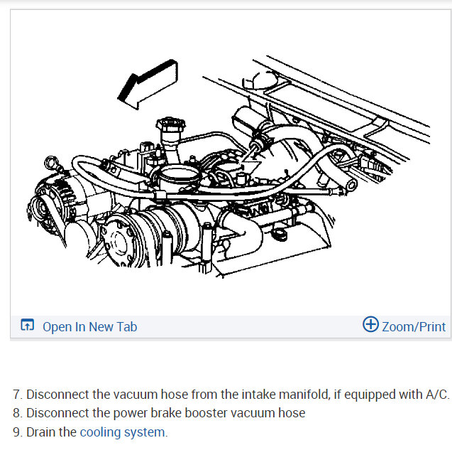

If the intake manifold is leaking that is where I would start. Also, check the oil filter and oil pan drain plug. I have also seen the oil pressure sender leak as well. The oil pressure is okay so I would not worry about that. This guide can help:
https://www.2carpros.com/articles/engine-is-leaking-oil
Please upload pictures or videos in your response to the problem so we can see what's going on. Here are the instructions on how to replace the intake manifold gaskets. Check out the images (below).
