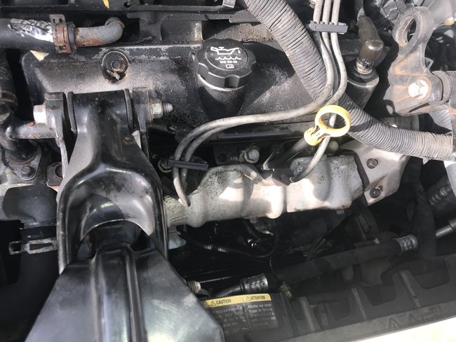

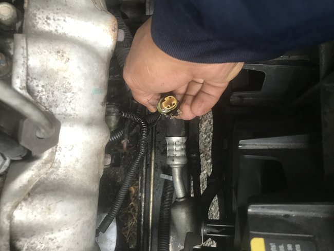

My car is leaking oil from this part of the engine in the picture. When that yellow piece is plugged into that hole and I start the car out oil steadily drips from there. Does anyone know what that part is called or how to fix it?

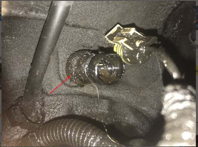

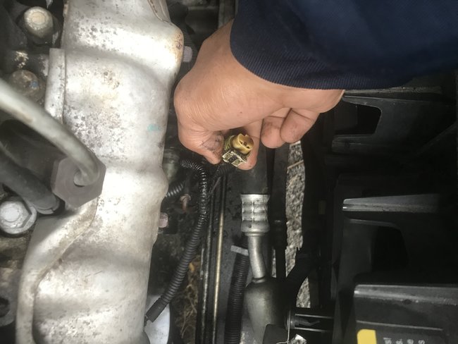

This is what I’m talking about, when that yellow piece is in and I start car up oil leaks there ? What is that ?

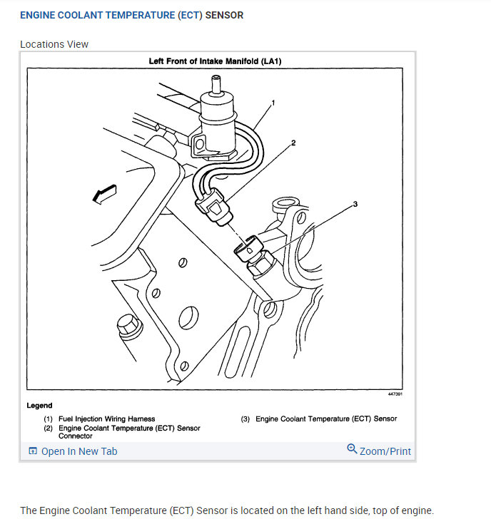

Can you do a couple things? First, can you remove the sensor so we can see the tip and that will confirm what I think it is. It looks like that is the engine coolant temperature sensor. So if that is the case then your coolant and oil are mixing. The oil does look thin and milky but not as bad as I would expect for it to be leaking out of this. It could also be the oil pressure sensor but it doesn't look like it is in the correct location.
Also, can you check the oil and coolant and see if they are mixed?
https://www.2carpros.com/articles/coolantantifreeze-in-the-engine-oil
Let us know this info and we can go from there. Thanks
Nov 17, 2020 at 4:13 AM

Sorry. Yes I mean to unscrew the sensor itself that I am pointing at in the picture.
However, before you do, can you get a picture of it a little further away and I may be able to confirm that it is the coolant temperature sensor? It looks like it is in the side of the block but it is hard to tell. Thanks

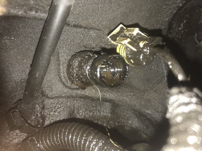

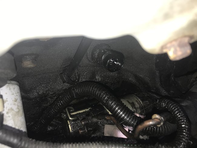

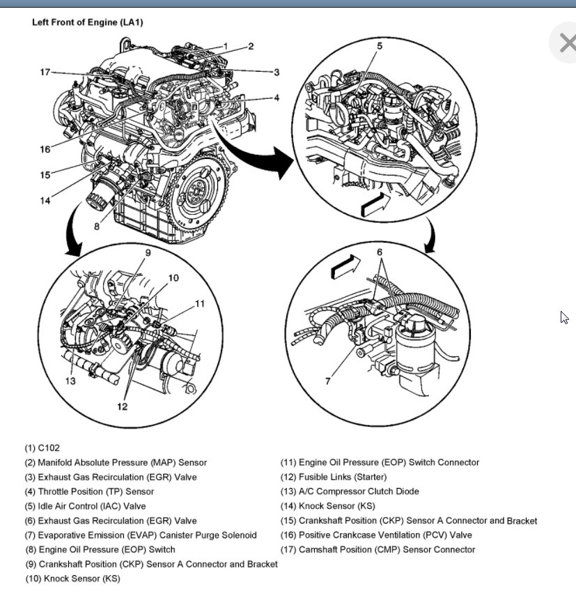

Here’s more pictures:
Nov 19, 2020 at 1:08 AM
CP313
  • 19 POSTS
It’s like up under where you see the oil dipstick.
Nov 19, 2020 at 1:09 AM

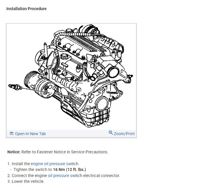

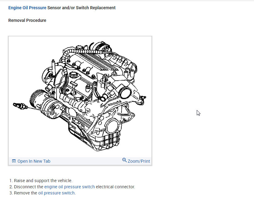

Got it. That is just above the starter which makes that the oil pressure sensor. I am attaching the process on how to replace that. This is good news because that is not uncommon and does not mean any other issues are with the engine. The sensor should have a seal on the sensor part that goes into the engine and they fail and it starts leaking. You can just replace the sensor or sometimes you can even find the seal and just replace that but the sensor is probably not that expensive.

Do you think I can do it without lifting vehicle? I think I can reach it from the top. do you know what I need to unscrew the sensor? I tried with my hand no luck.
Nov 19, 2020 at 3:31 PM
CP313
  • 19 POSTS
I went and got a deep socket today and the sensor switch, but I can’t get the old one off. the deep socket won’t reach .
Nov 20, 2020 at 2:22 AM
CP313
  • 19 POSTS
Thanks bro. I changed the switch today and the leak is gone! At 230,000 miles she drove great all day. :) thanks
Nov 20, 2020 at 2:54 PM
Sorry I didn't get back to you earlier. Yeah deep sockets would work great but they normally don't reach. Normally a wrench is the only thing that works. So glad you got it replaced and everything is doing well.
