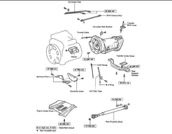

I need to install a new gasket to fix the leak. Do you have an step by step video guide or technical manual, so I know what to remove to access it?
Taking the engine out of the truck is out of the question. All work will be performed while under the truck.

Good evening,
The transmission has to be removed to access the rear main oil seal.
Do you have the tools to remove the transmission?
https://www.2carpros.com/articles/transmission-replacement-removal-manual
This is a huge project for doing it on the ground.
