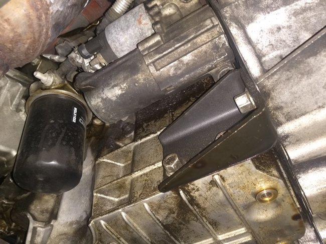

My car has an oil leak, it does not seem to be losing oil too fast, because I can barely notice the oil loss. Where might this leak be from? I attached a picture.
Nov 21, 2018 at 12:58 AM
Good afternoon,
From your picture, it could be the oil pan gasket.
You have to be sure it is not coming from the top. Look at the top of the motor and see if any oil is making its way down the motor.
This repair is quite involved. I would have someone look at it for you and verify it. Have them check the bolts as they may just need to be tightened up.

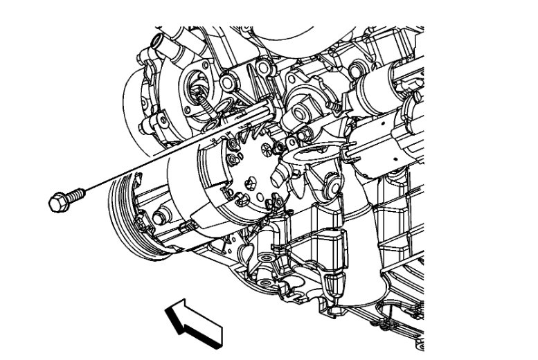

5. Remove the starter motor. Refer to Starter Motor Replacement (LZ4-3.5L) (See: Starter Motor > Removal and Replacement > Starter Motor Replacement) .

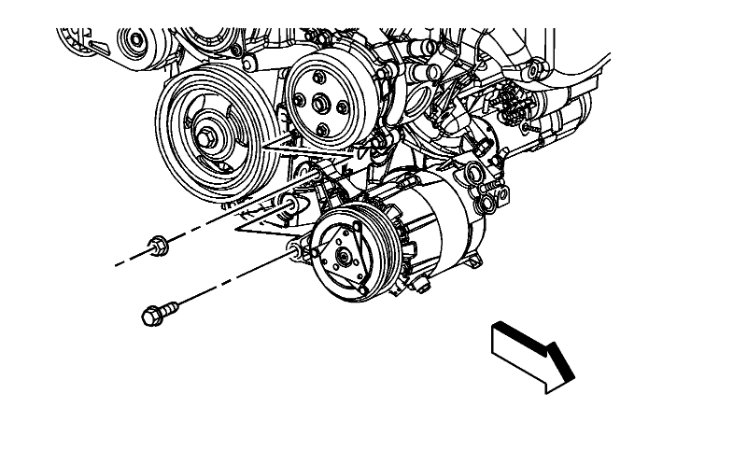

8. Remove the air conditioning (A/C) compressor nut and bolt.
9. Remove the A/C compressor rear bolt and position the A/C compressor aside.

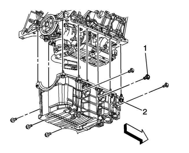

10. Remove the horizontal oil pan bolts (1).
11. Remove the vertical oil pan bolts (2).
12. Remove the oil pan.
13. Remove the oil pan gasket.
