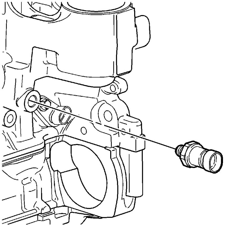

Correction it looks like the gasket behind the Starter and where the Oil Pressure sensor. Right below the manifold or the oil pan gasket.

Oil pressure senders are a common leaking point. The leak near the starter could be a valve cover leak weeping down that way. The sender is easy to change. Get the new one (GM please, aftermarket ones tend to leak faster) and get the oil pressure sender socket as well as a loaner tool. Then remove the electrical connector, unscrew the old sensor and screw in the new one be careful as it's easy to do damage if you tighten it too far. The spec is 16 ft lb, or just snug.

In that area of the oil pressure sender. The other sensors horizontal of the oil pressure sender are all coated with dirt from grim. Could be from the unit or along where that gasket needs to be replaced.

Grab a can of carb or brake cleaner and hose off the grime and see where it is leaking from. The senders can spray out oil that gets blown around by the airflow under the hood. Other leaks will tend to seep and run down. That is where the powder trick can help as it will show the direction of flow.
