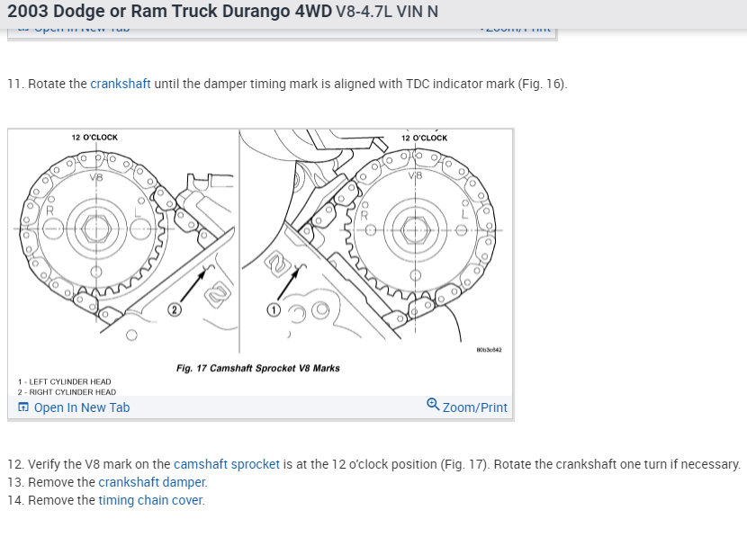

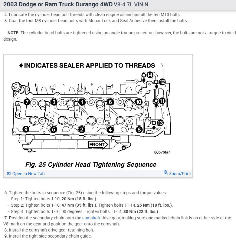

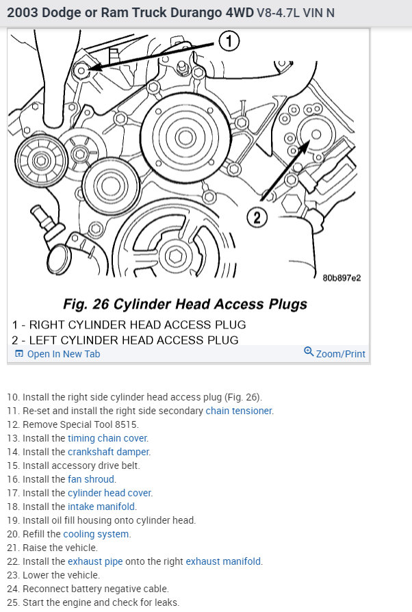

I recently changed the head gaskets and timing chain. After putting everything back together, I cranked it up and it ran just fine. However, oil began to leak from the engine like a waterfall! I looked underneath the vehicle and it seemed to be coming from the rear top of the engine, but I could not see from exactly where. I went to the top of the engine and put my hand around the back of the engine to try to feel where the leak might be. I felt that the oil was "puddling" under the intake manifold between the heads. Did I miss a step in the re-assembly, did not tighten something at the right torque or has something gone bad like a seal? Why would oil puddle under the intake manifold? Would it leak somewhere from one of the heads... if it was cracked?

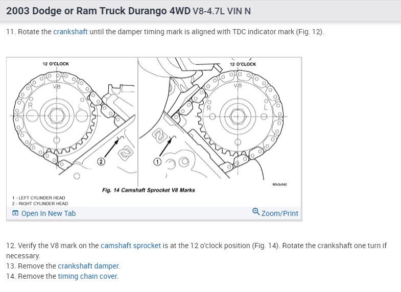

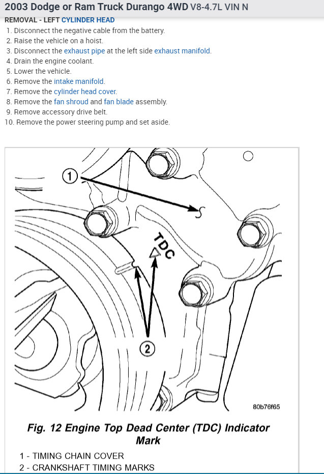

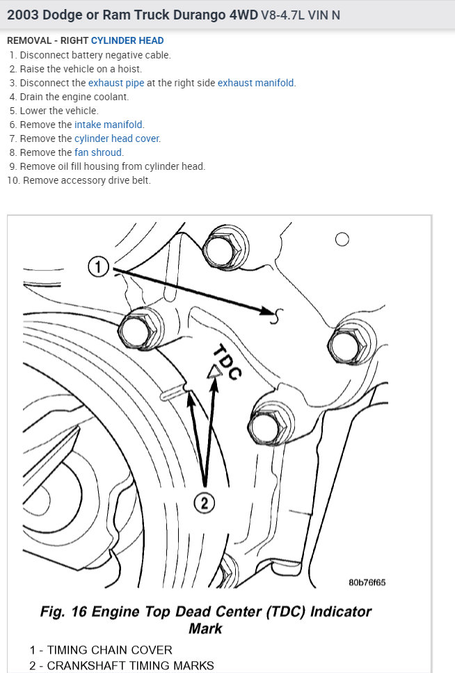

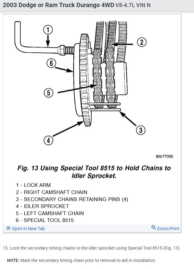

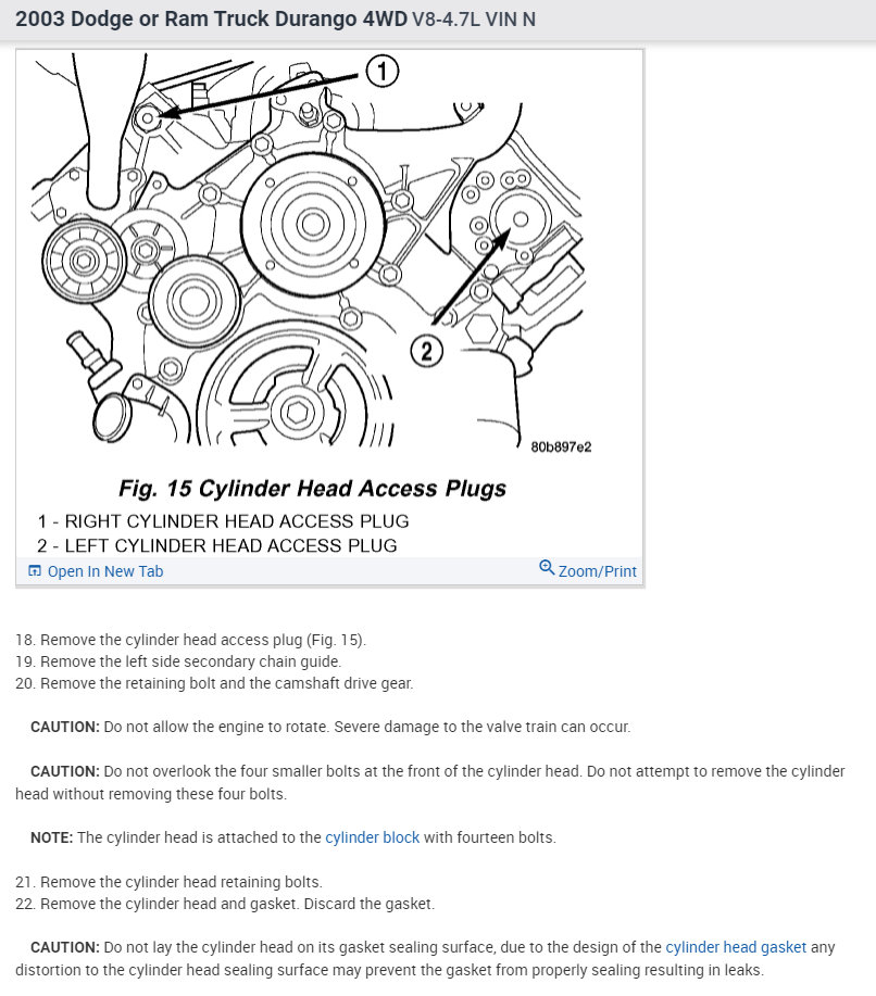

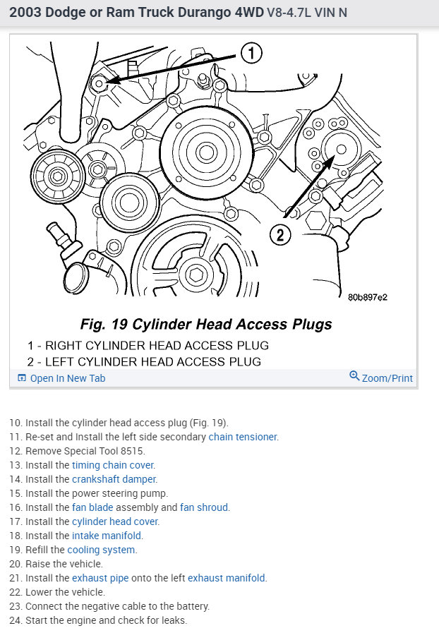

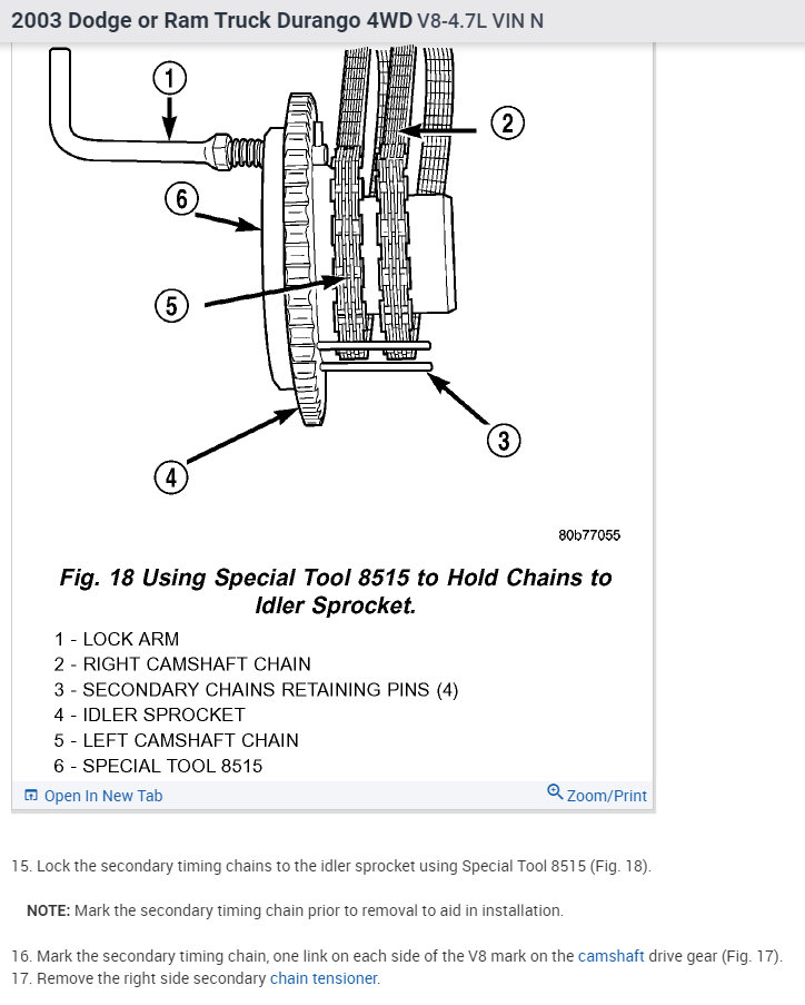

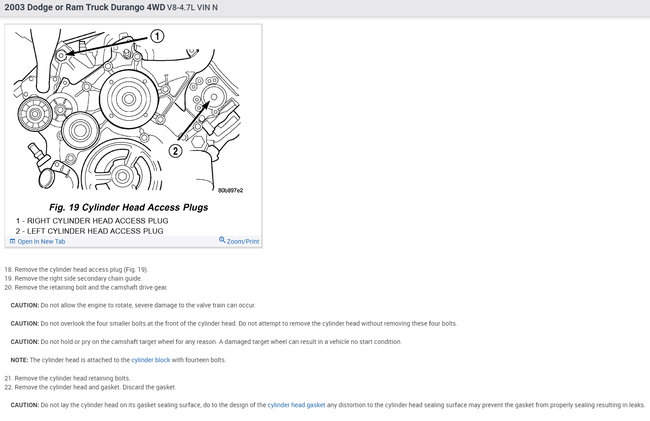

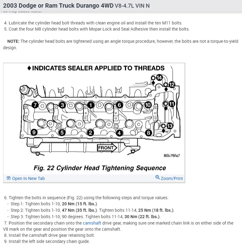

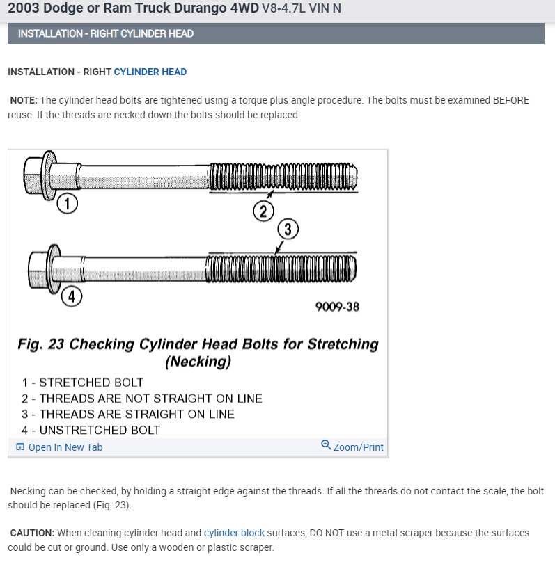

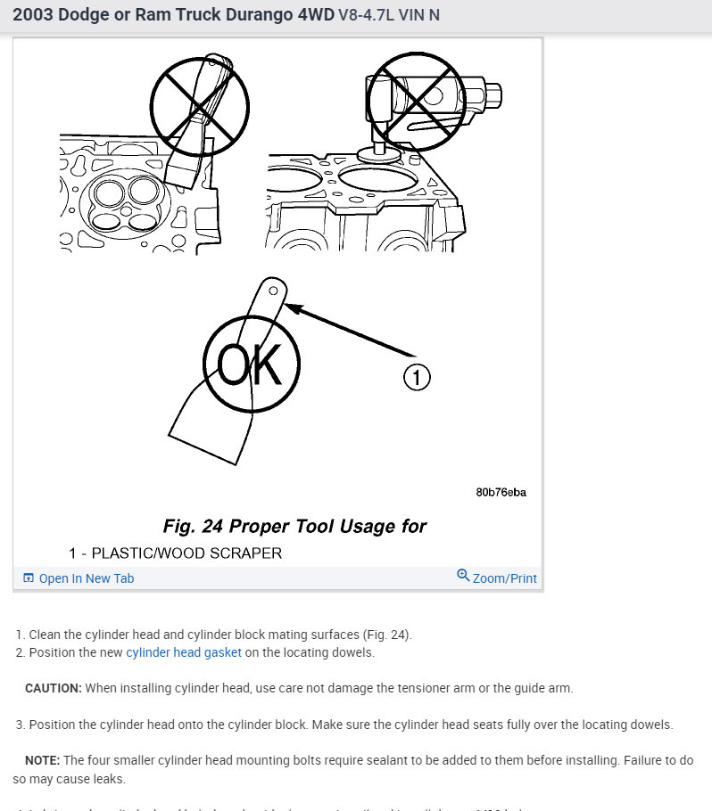

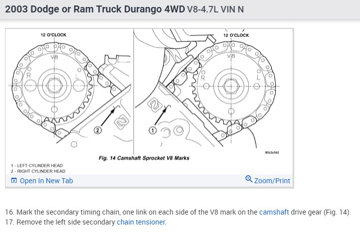

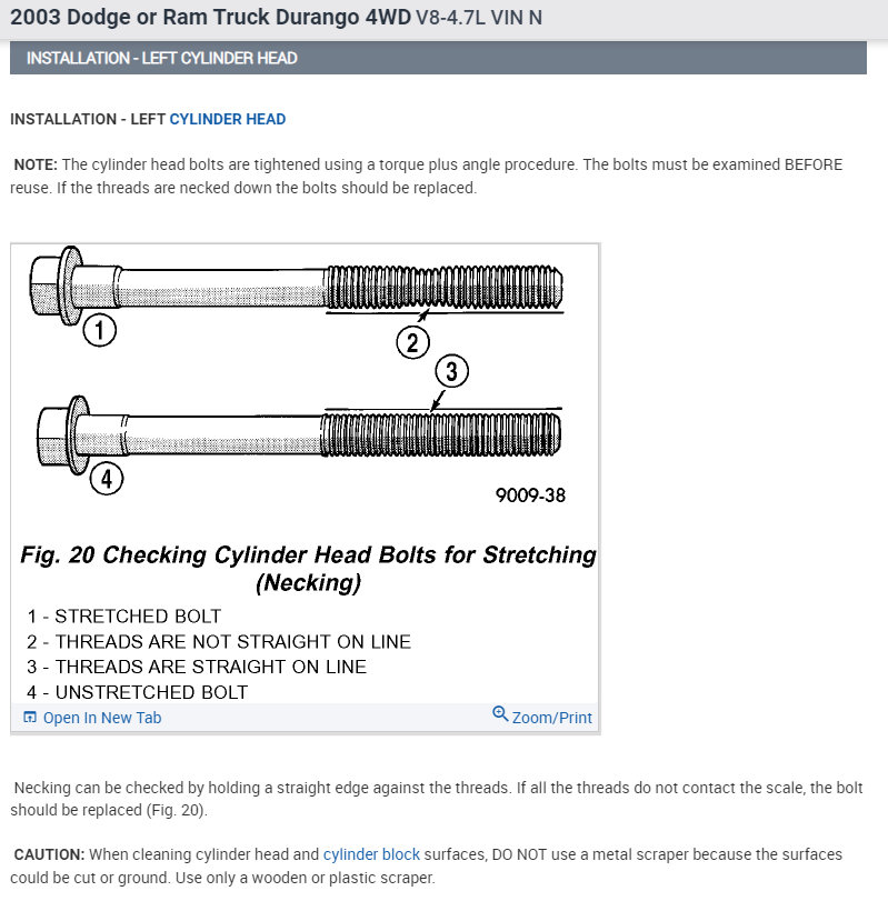

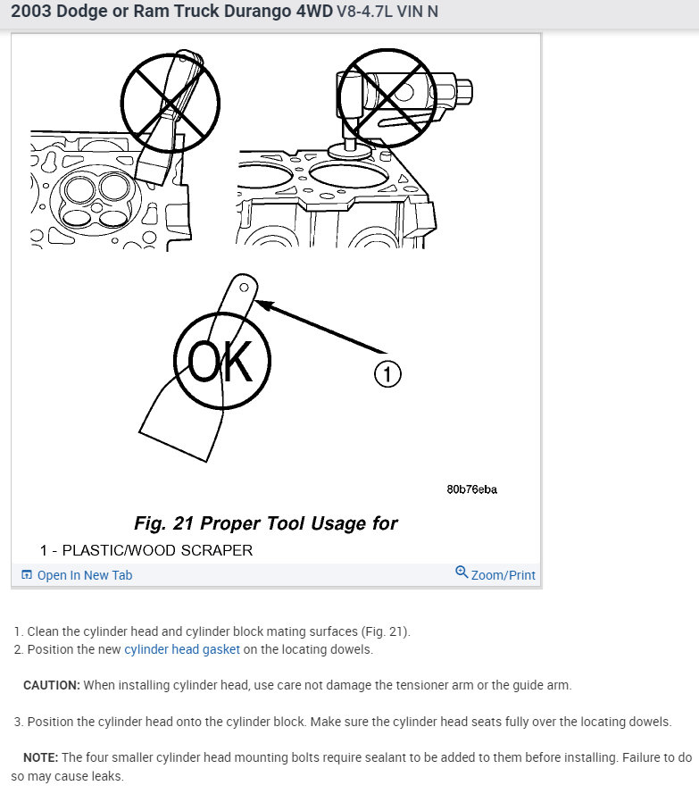

It is possible something did not get aligned or you might have a bad gasket.
It can also leak due to not having the old gasket residue completely cleaned.
Did you have overheating issues before the head gasket replacement?
As if the engine overheated it is possible to have wrapped component due to excessive heat.
I have attached the head gasket replacement procedure including the torque specifications and torque sequence below for your reference.
https://www.2carpros.com/articles/engine-is-leaking-oil
