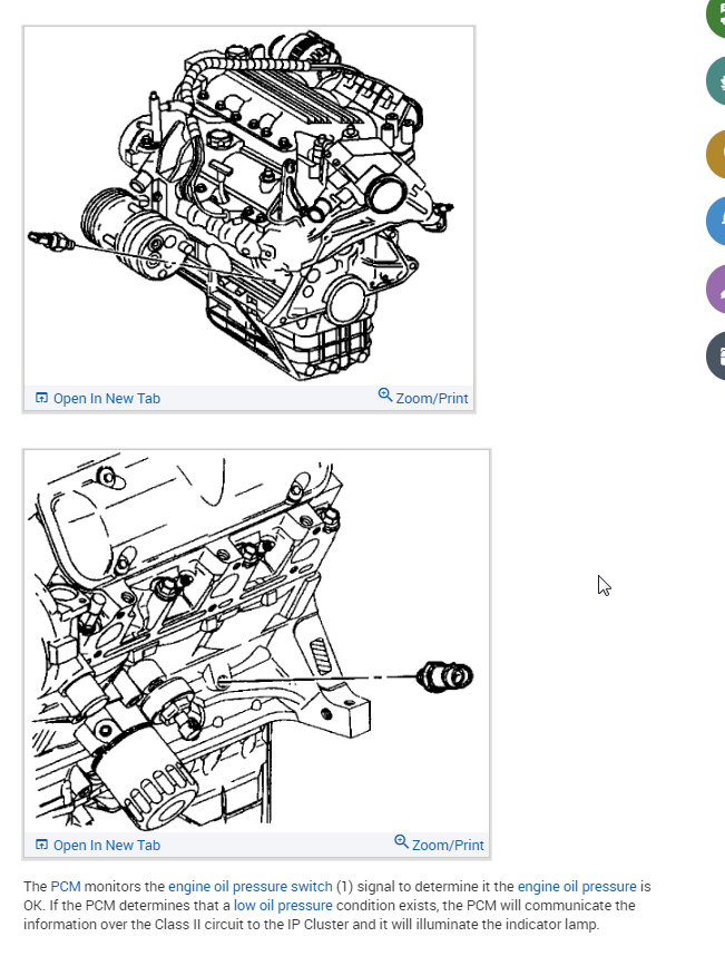

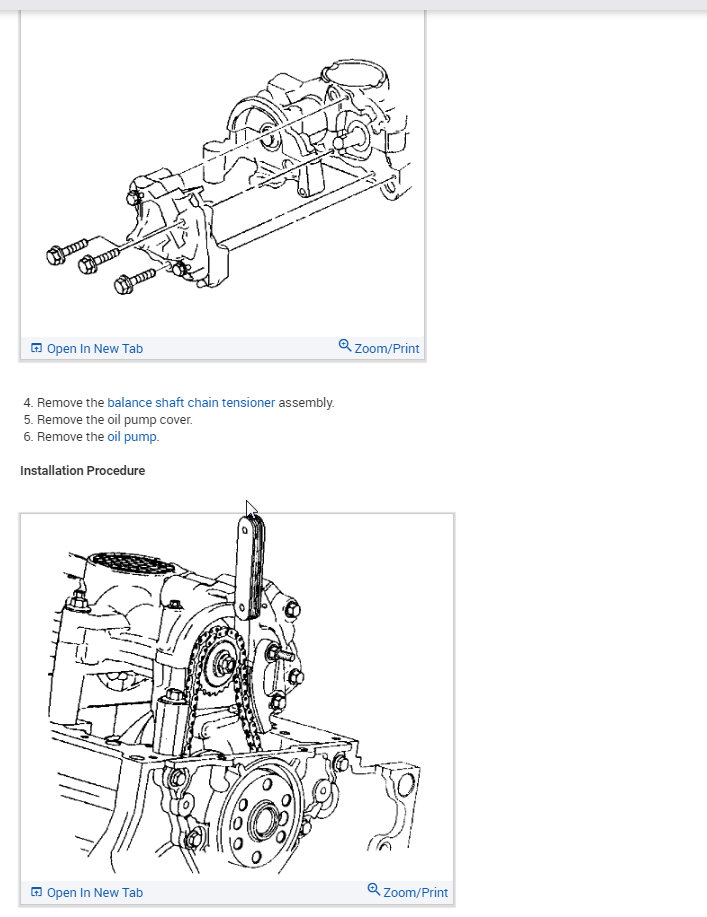

Where is the oil pressure sending unit on the car listed above 3.4 L?
Feb 7, 2020 at 5:53 PM

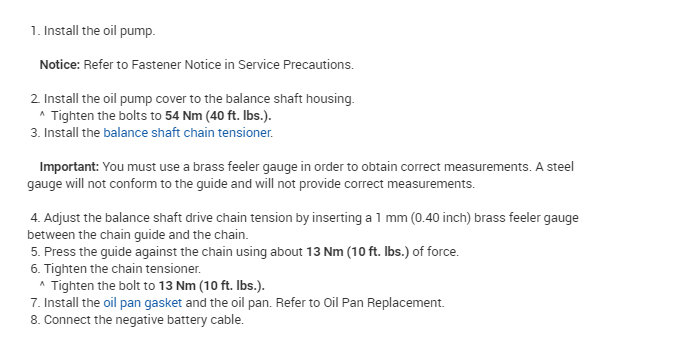

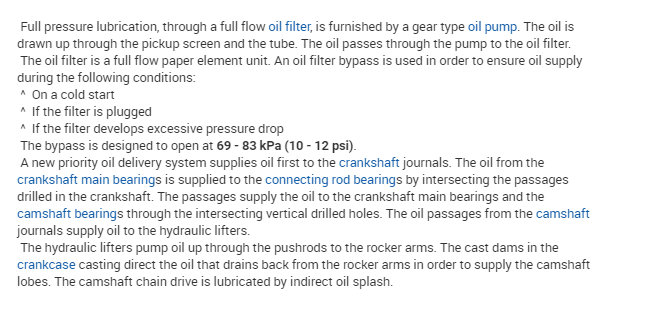

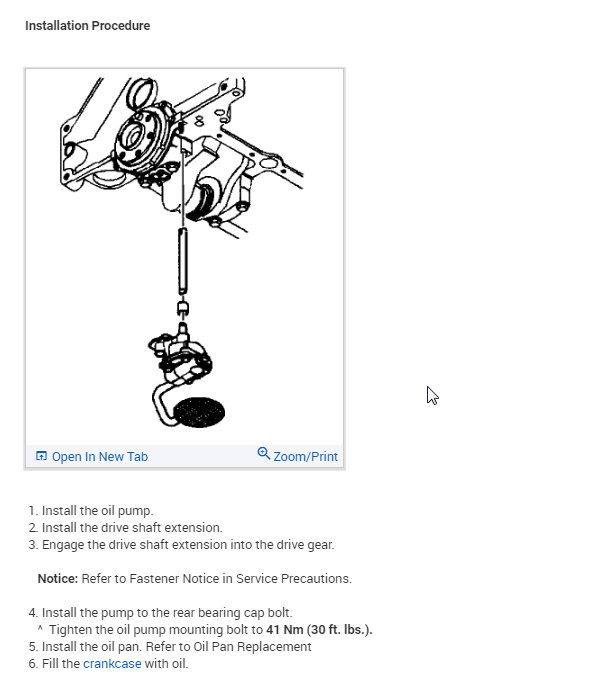

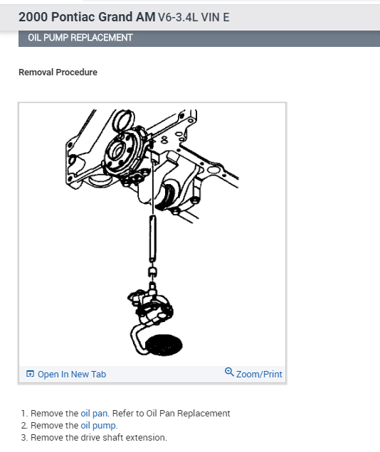

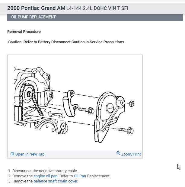

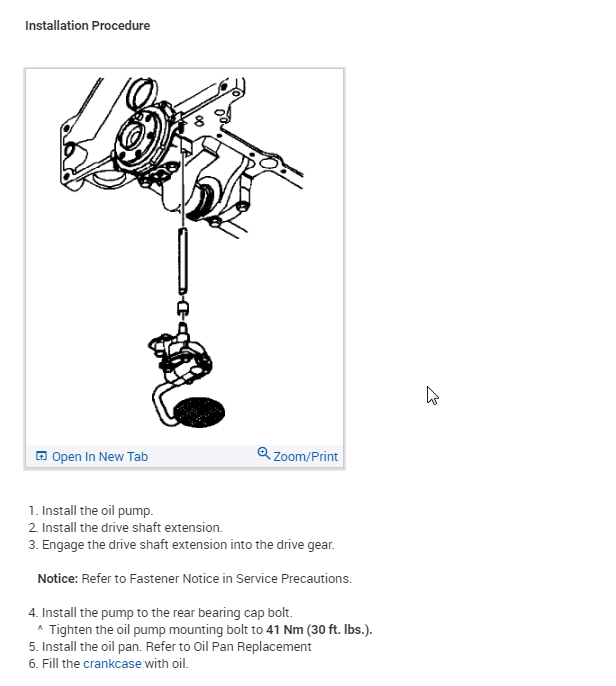

When you say "sender" are you talking about the oil pump? I have found that some confuse the pump/sender with the sensor.
Assuming you are talking about the pump, I included the process to replace the pump on both engines because I am not sure which one you have. Either way, it is in the oil pan.
Let me know if I am missing something. Thanks
