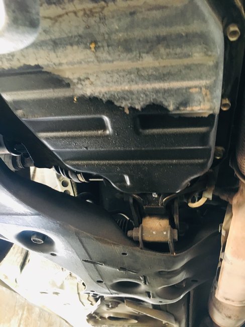

I just bought this car and I check my engine oil daily, but my dipstick is showing a reduction in oil with huge difference every day. Like I changed my oil last week and now the dipstick is showing oil below the low level. My engine exhaust is not showing any white smoke, my engine sound is also perfect and there is no low oil sensor indication on my dash. Please help guide me through the problem. The engine is 2.5li DOHC V4, I guess.

Okay, the oil is going somewhere. It is either leaking somewhere or it is being burnt in the engine's combustion process. So let's look for leaks. Look at the valve covers, head gasket, timing chain cover. You might need to jack up and support the vehicle to get underneath of it and here is a link for you to go to explaining how to do this properly below:
Look at the oil pan, front and rear main oil seals and the oil filter and oil sending unit. If the vehicle is leaking oil it should be readily apparent with a lot of it blown from the leak. Please check your vehicle for oil leaks and get back to us with what you find out. We will go from there.

There is oil leakage from the bottom, but I cannot confirm it, either is transmission oil or engine oil. Because a person was saying that it is transmission oil leakage. How can I confirm that?

Hello again,
Is there any way you could get under the vehicle and snap a few pictures of it and upload it to us? Also transmission fluid is usually reddish in color and engine oil will be black. Please get back to us with what you can deduce from the information or with a few pictures.

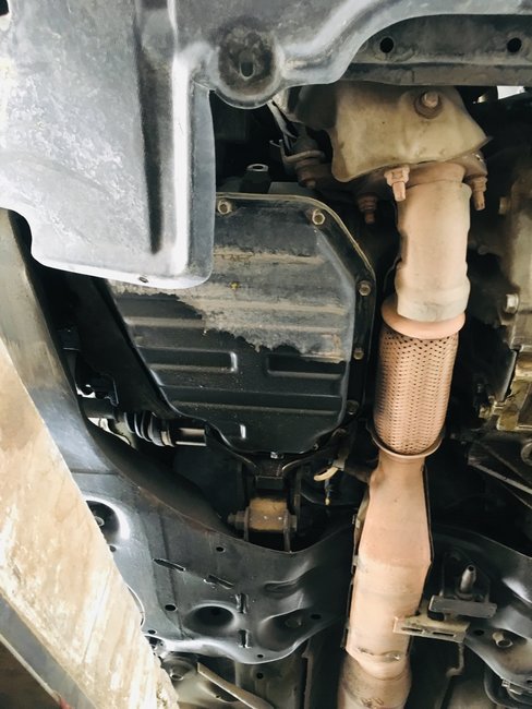

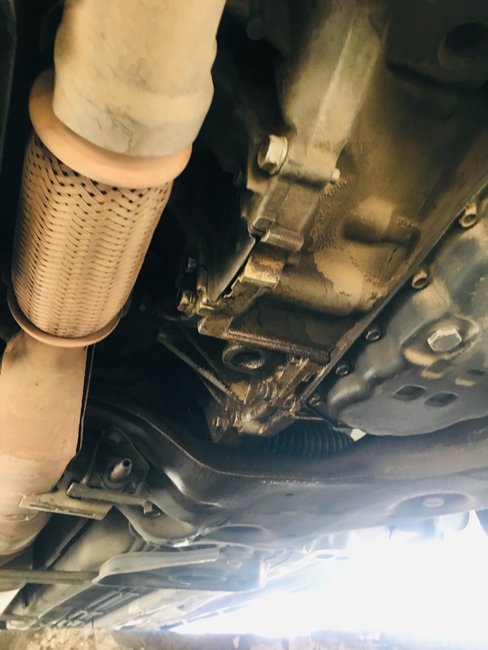

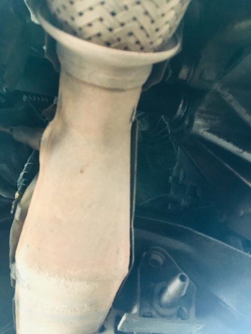

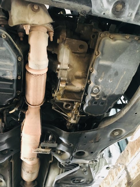

These are the possible shots that I could take. I hope these are helpful. Today I added w40 oil of fuchs. Before that i was using 10w30 of petromin. I though the thickness might help.

Hello again,
Okay, if the oil is coming from the front of the engine around the crankshaft pulley then it will be a front main oil seal that is leaking. If not then it looks like it will be the oil pan gasket that's leaking, Please check the front of the engine around the crankshaft pulley and get back to us.
