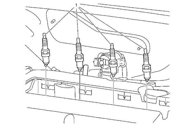

I saw small droplets of oil beneath the water tank. I sent it to a mechanic to seal but afterwards, I am seeing oil in my water reservoir.

1. Remove the throttle body. Refer to Throttle Body Assembly Replacement (1.6L LDE, LXV, 1.8L 2H0, and LUW) (See: Throttle Body > Removal and Replacement).

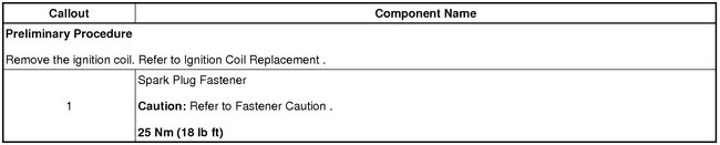

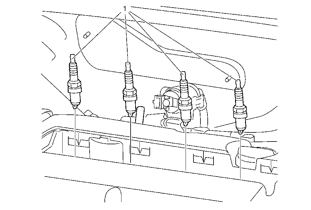

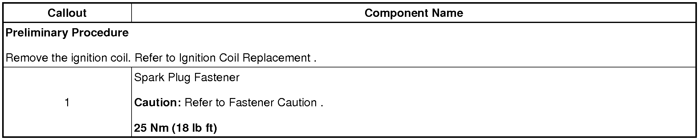

2. Remove the spark plugs. Refer to Spark Plug Replacement (See: Spark Plug > Removal and Replacement > Spark Plug Replacement).

3. Install the spark plugs. Refer to Spark Plug Replacement (See: Spark Plug > Removal and Replacement > Spark Plug Replacement).

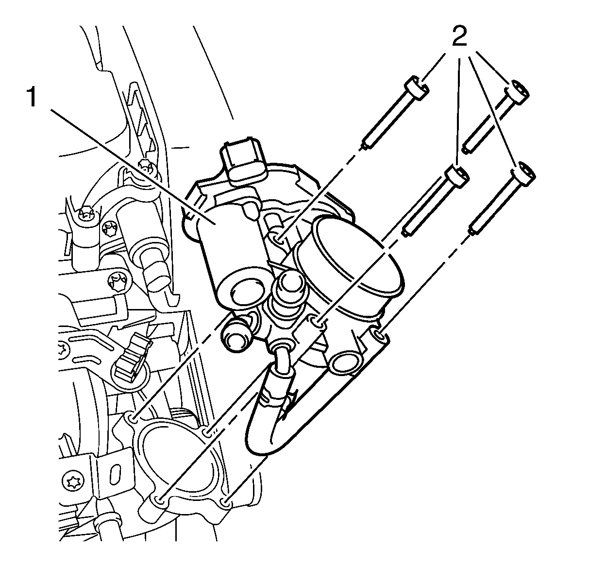

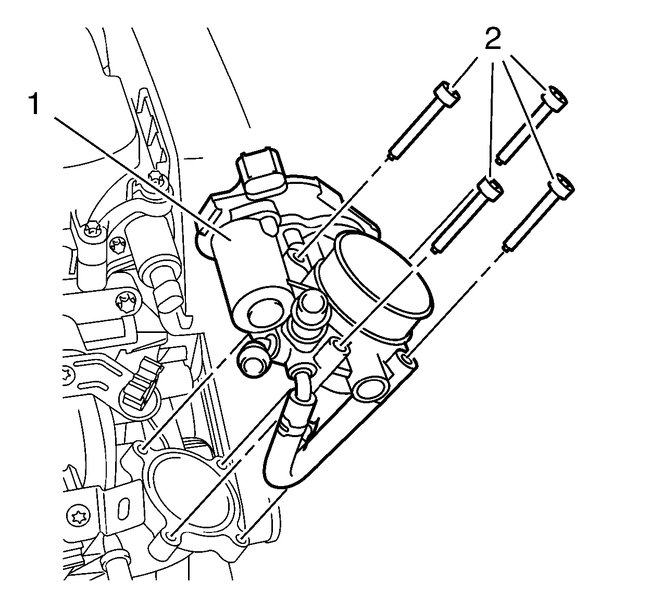

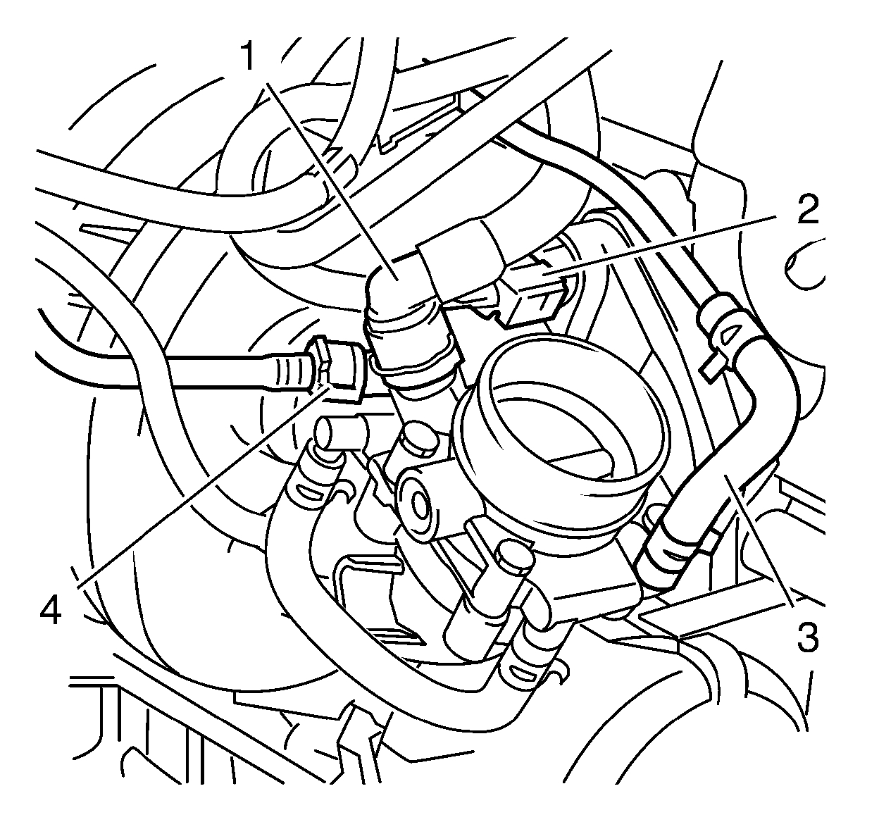

Here are the components that need removed.
______________________________
Throttle Body Assembly (1.6L LDE, LXV, 1.8L 2H0, and LUW)
Removal Procedure
1. Open the hood.
2. Remove the air cleaner assembly. Refer to Air Cleaner Assembly Replacement (1.6L LDE, LXV, and 1.8L 2H0) (See: Air Cleaner Housing > Removal and Replacement).
3. Disconnect the wiring harness plug (2).
4. Disconnect the positive crankcase ventilation pipe (1).
5. Place collecting basin underneath.
6. Disconnect the throttle body heater outlet pipe (4).
7. Disconnect the throttle body heater inlet pipe (3).
8. Remove the 4 throttle body bolts (2).
9. Remove the throttle body (1).
Installation Procedure
1. Install the throttle body (1).
Caution: Refer to Fastener Caution (See: Vehicle > Vehicle Damage Warnings > Fastener Caution).
2. Install the 4 throttle body bolts (2) and tighten to 8 Nm (71 lb in).
3. Connect the throttle body heater inlet pipe (3).
4. Connect the throttle body heater outlet pipe (4).
5. Connect the positive crankcase ventilation pipe (1).
6. Connect the wiring harness plug (2).
7. Install the air cleaner assembly. Refer to Air Cleaner Assembly Replacement (1.6L LDE, LXV, and 1.8L 2H0) (See: Air Cleaner Housing > Removal and Replacement).
8. Close the hood.
_____________________________________________
See pics 5 / 6 for spark plug removal.
