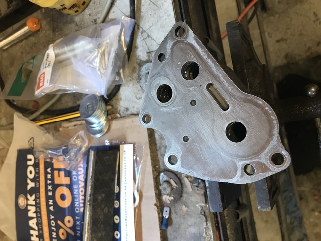

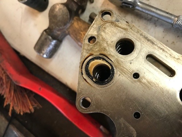

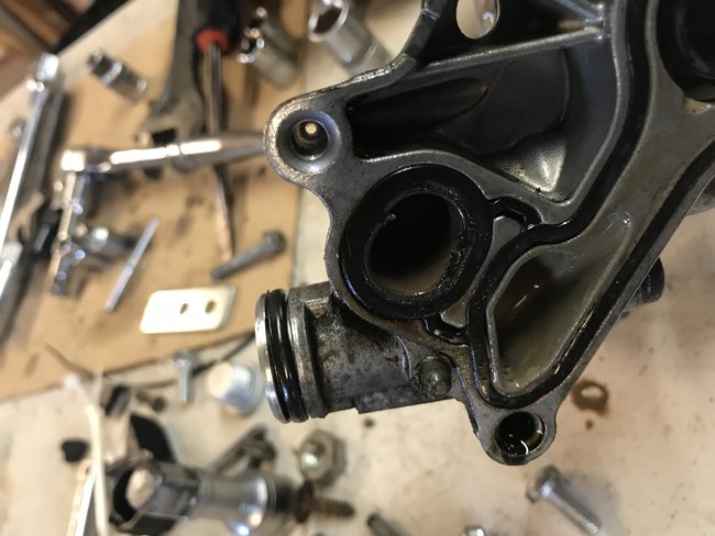

I took the turbo and oil cooler off.
Stripping the cooler shows damaged gaskets oil/water so I’ll get new parts, rebuild and do your test you described ie; oil, a little water in it and see how it runs with sniff test.

Sounds great. Thanks for the pictures that is great info. Let us know what you find.

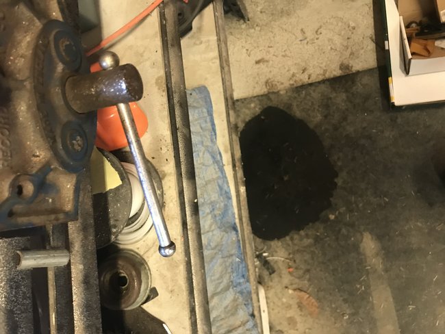

Kenny, I tested the oil cooler. The air side seemed to hold pressure okay.
Set cooler up level and filled the oil side with diesel. It all drained out overnight via water inlet. See pics, dark stain on floor is the diesel. So, the cooler leaks but how is the sump getting water ingress?

Maybe I am not understanding the question. If you filled the oil side with fuel and sealed it off so that it held but it still leaked out, then it would have come out the coolant passage, correct?
If that is the case then water is getting into the oil pan due to the oil and coolant mixing. Normally it goes oil into the coolant because the oil pressure is higher but it will go back the other way when the engine is off because the cooling system holds pressure when the engine is off and the oil pressure drops to 0 PSI.
