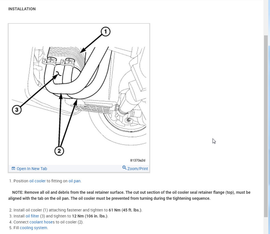

I did the engine block test to see if it might be a blown head gasket and the test came in negative. What can it be? Maybe the oil cooler?
Wednesday, April 8th, 2020 AT 2:14 PM

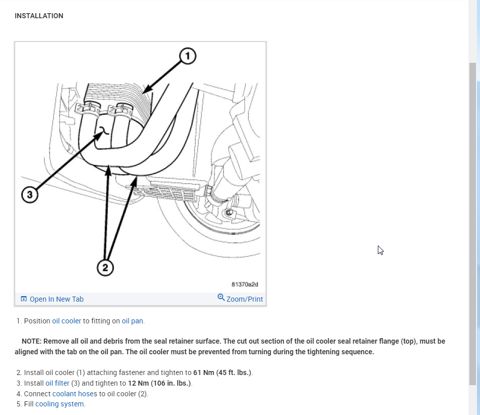

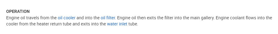

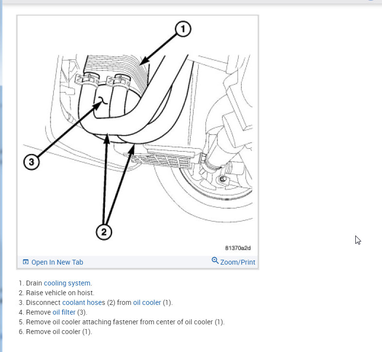

Yes. You are probably correct that the cooler is the issue.
Here is a guide that talks about this issue in general terms but I attached the process on how to replace it:
https://www.2carpros.com/articles/coolantantifreeze-in-the-engine-oil
Let me know if you have questions. Thanks
