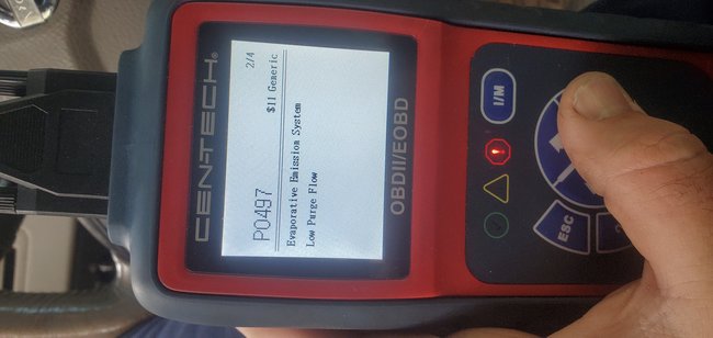

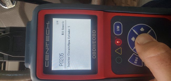

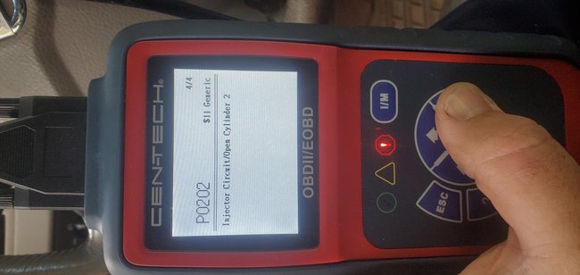

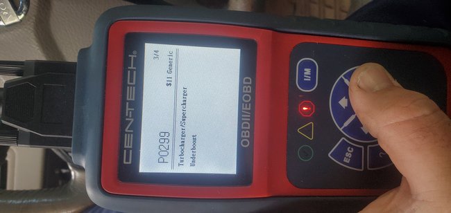

So I believe I'm having some crank case pressure issues and bad turbos. When i first start the car in the mornings it runs fairly good and have some boost from the turbos. But after 15 minutes of driving I lose most of my boost and has no power. I have a good amount of oil In my inter cooler pipes but she does not smoke much. This morning my engine oil dip stick pop up and sprayed engine oil everywhere. I have three check engine lights on two are fuel injector circuit open and one is a low boost code.

Hello and welcome to 2CarPros. Can you post the exact trouble codes you got? Also with the vehicle running, remove the oil cap. Place a piece of paper over the filler hole to see if there is a slight vacuum. If you can post a video of the test that would be great please.

Hello and welcome back. Check injector #2 and #5 connector to verify it is properly secured and locked. If the lock is broken then you can order just the connector housing to replace it. If properly secured then disconnect it and check for injector pulse. Here is a link that shows you the steps. Scroll down to step #7.
If you have a pulse then the injectors are open circuited and will need replacing. For the slow purge fault, a software update usually corrects this fault. That would be the first step you need to have done. If you have the latest and greatest then the purge valve could have a very small leak but usually the leak detection pump is what fails with these vehicles.
The boost fault, check inter-cooler hoses and charge pipe to verify you have no leaks or disconnected hoses. Inspect your turbo control valve hoses and verify they are connected to the right ports. They are color coded so make sure the colors corresponds to where it is plugged into. Some oil in the cooler is normal. All turbos do that.
