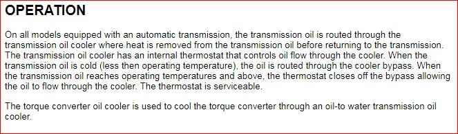

Have you checked your transmission fluid for coolant? The only reason I ask, is these trucks has a trans oil cooler that has been known to crack. When it does the coolant and trans oil mix and create a milky sludge. Sometimes white in color, sometimes darker depending on the condition of the trans oil.

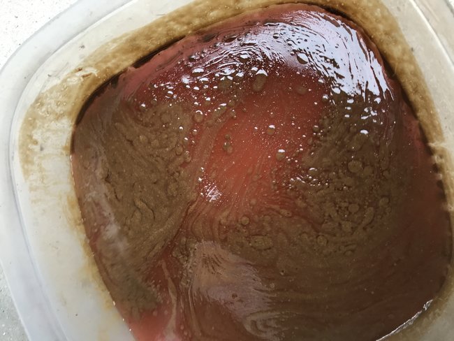

Thanks for the information, I have no way to check the transmission fluid as I have no dip stick, unless I want to have it serviced. I plan on having a leak down test, the coolant in the radiator looks fine but has a slick texture to it, almost feels like mineral oil watered down. I siphoned out the reservoir tank and it looked to be yellowish brown, like motor oil that is time to be changed.

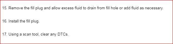

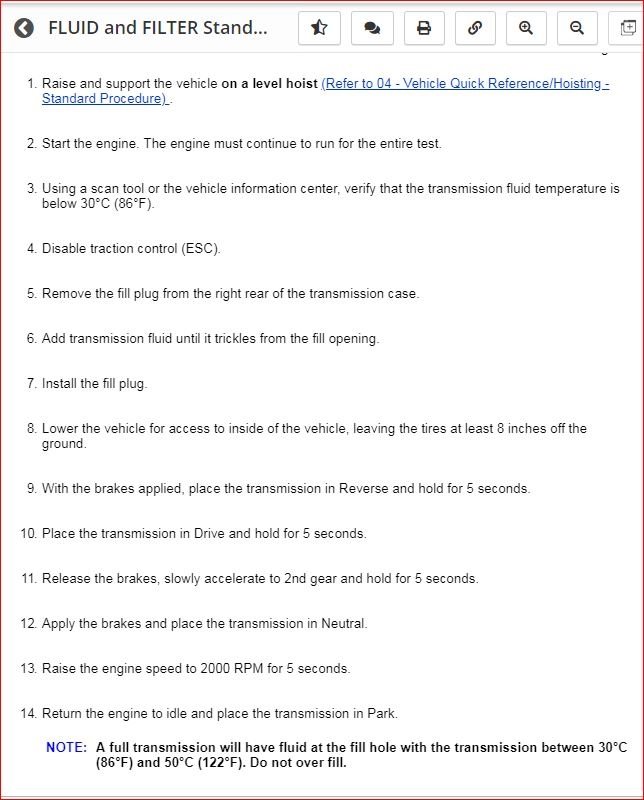

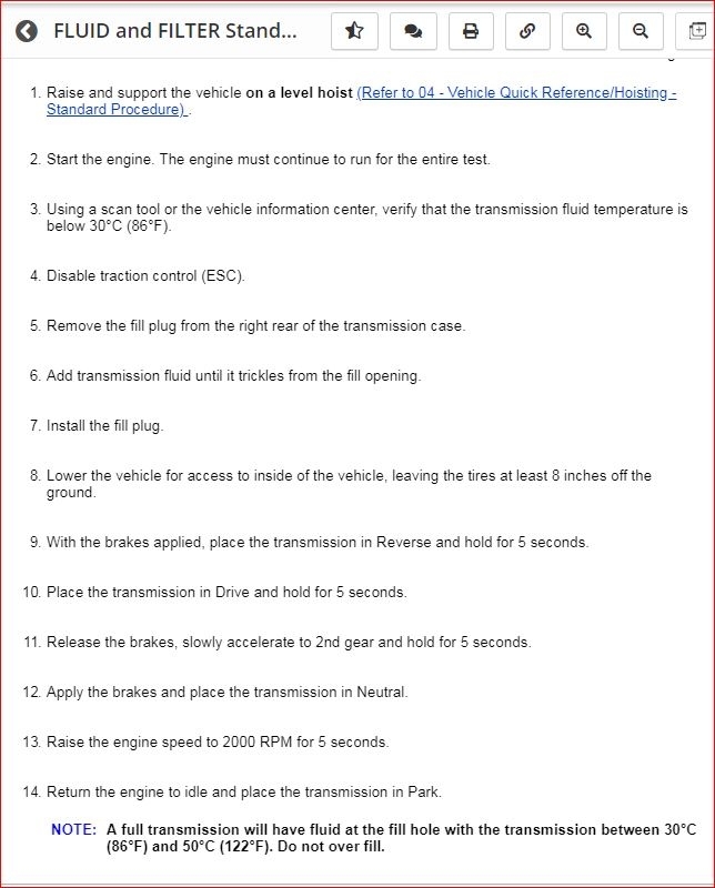

Unfortunately that sounds like transmission fluid. If you don't have dipstick that means you have an 8HP70 transmission. Here is a video and the written instruction on how to check the fluid.
If you notice in the video the color of the fluid he is using. It is a greenish color and feels very much like mineral oil. It is not traditional pink/red transmission fluid. If mixed with coolant it can darken in color.
I have seen a few of these where the cooler cracks and the trans and coolant mix. IF this is the case, it sounds like you caught it at the beginning stages.
If it were me, I would pull that plug and inspect the fluid in the trans just to be safe. Obviously if you do this after the leak down test, that would be fine because if you find a head gasket issue then this would confirm engine oil.
https://youtu.be/BPkCUfqi-gE
Let me know what you find. Thanks

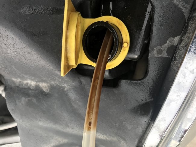

Thanks again. here is some pictures of what I pulled out of the coolant reservoir and what was on the dip stick.
Jun 7, 2019 at 7:19 PM
That looks familiar. I agree that it looks like engine oil and it could be, but I have seen this a number of times and that white gooey residue around the side will eventually be throughout your cooling system. I would check both the cylinder leakage and the trans fluid just to be sure.
