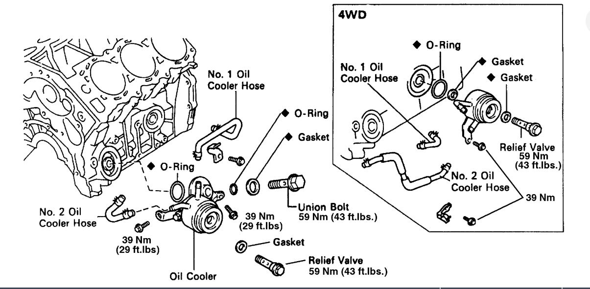

Did head gasket, cylinder resurface (had crack replaced head), water pump, timing belt, radiator, coolant and heater hoses, thermostat and still oil in coolant. Now what?

This could be a bad oil cooler. there is coolant that runs through the cooler and if the cooler fails it will mix oil with the coolant.

This is a manual transmission, no oil cooler.
Dec 19, 2018 at 8:58 AM
No, not a transmission cooler, an oil cooler which is part of the oil filter adapter.
it does not matter if it is manual or automatic.

This vehicle does not have engine oil cooler.
Dec 19, 2018 at 10:11 AM
Okay, the diagram I have shows it does but that is okay.
The only thing left is a cracked block. that would be the only way to transfer oil into the coolant since you had the top end redone.

That's what I was thinking, just hoping there was another option.
