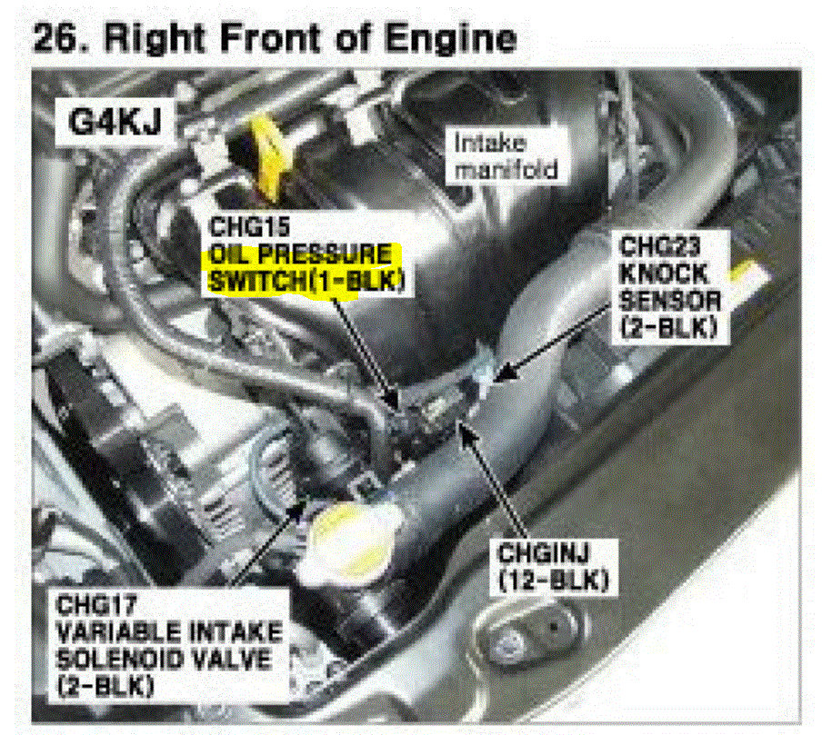

Are you certain it is engine oil? If so, could you upload a pic of approximately where you see it coming from?
The first thing that I thought of was whether the oil filter is leaking or the oil pressure switch. Check both. I attached a pic below showing the location of the oil pressure switch.
See pic below.

It's definitely oil, and I couldn't find an external source of the leak. seems to be middle of the engine , behind throttle body towards firewall
Leaking about as fast as you can pour it out of the bottle
When I removed the air intake / filter housing (everything in front of the throttle body) to get a better look, I noticed some oil at the bottom of the butterfly - and when I pushed it in it was full, close to a pint spilled out when I remove the throttle body
The filter housing is fine - when under the car, the leak is coming somewhere from the driver's side about a foot above the oil filter housing (driver side of intake manifold). the oil pressure switch from the pic you sent looks to be passenger side and take manifold and that still wouldn't explain a throttle body and intake full of oil, right?

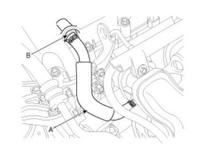

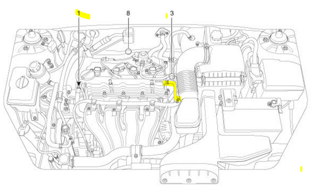

If it is leaking that badly and is getting into the throttle body (which should be sealed), remove the PCV valve and see if it is full of oil. (See pics 1 and 2). Also, just to confirm, this isn't a 2.0L turbo, correct?
I ask because if it is getting into the TB, it has to be going through the airbox. That is confusing me. Check the PCV.

I disconnected the hose labeled "3" when I removed the air box, there was no oil evident.
The front of the throttle body looked clean, seems like it's coming from behind it somewhere in the intake.
Is that hose labeled "1" where the PCV flows into the intake?
(I think "B" in the pic is the PCV valve, correct?).
Could too much oil in the crankcase end up flowing through there into the intake?
I can't think of any other way for oil to even get in there.

Check the oil level. That is a good idea. And yes, letter B shows the PCV valve. Also, the other is where it connects. But, if it is flowing from the engine into the TB,
Could you take a few pics of where you feel the leak is coming from?
Also, make sure the PCV isn't clogged. If it's good, then I may suggest a compression test. Something may be creating too much crankcase pressure.

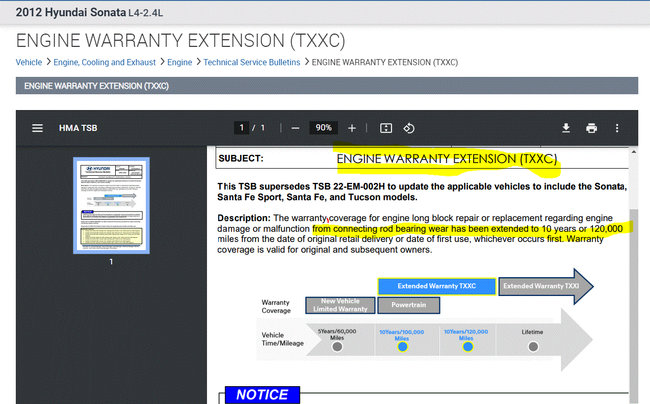

I know there was a recall related to engine oil consumption. If you look below, I copied one of the issues related to the recall. It was piston compression rings. See pic 1. The interesting thing is this. The only thing that can allow oil to get to the air induction tube and the throttle body has to come through the PCV/Breather. There really isn't any other way. If you had or still have a major leak, is it possible that somehow the leaking oil made its way to the air box and was drawn in?
Let me know. Also, because there is a recall on the engine, contact a Hyundai dealership and describe what is happening to see if it is related to the recall. I know they were replacing engines. (I don't work for Hyundai) I'm suggesting this because I know there was an issue.

I attached a recall below where Hyundai extended the engine warranty to 10 years 120K due to connecting rod bearing wear. This sounds like where the problem came from. The only issue is you are at 125K and close to the 10 years if that hasn't already expired. That is where the arguing will come in. They should replace the engine with a new one free of charge.
Let me know if you want to pursue this. I attached the recall below. Take a look at it and let me know if you have questions.

The idea that you heard a knock originally leads me to think this is the cause. The TSB I attached above is from Hyundai, so I have no idea why they are saying it doesn't exist.
Tell your customer the TSB number. See pic below of the original TSB.
