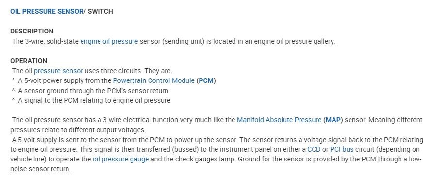

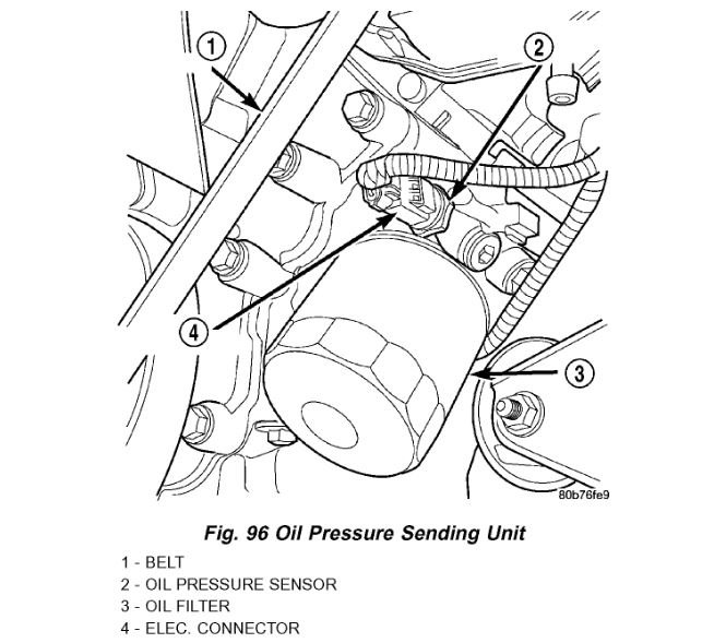

it's going up and down started doing it.
Mar 14, 2020 at 3:42 PM
Good afternoon,
Did you check the oil level?
Does the engine make any noise when this happens?
It could be the oil pressure switch.
https://www.2carpros.com/articles/high-oil-pressure
