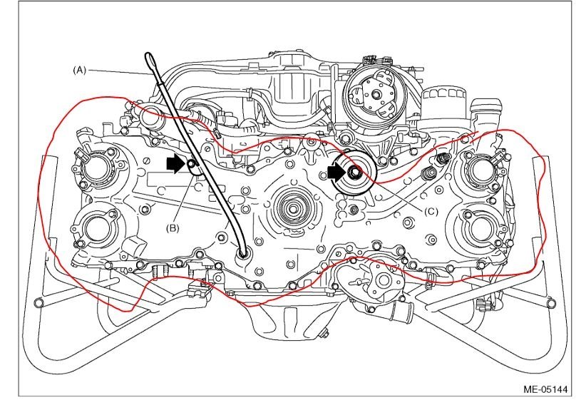

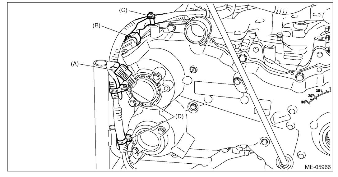

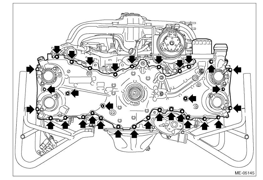

I have a timing gasket oil leak, can I use oil leak stop or will that result in further problems? If that isn't an option will replacing the gasket require the engine to be pulled? How long can I go without repairs? Will I be okay as long as I keep oil in the vehicle?
Jul 1, 2020 at 4:15 AM
Good morning,
Never, ever use stop leak. First, it never works and second, it will damage all the other seals with the additives it has in the product.
https://www.2carpros.com/articles/engine-is-leaking-oil
The front cover will have to be removed and the seal replaced.
No, the engine does not have to be removed. It is a major job but does not require the engine to be removed.
Yes, it will be okay as long as you keep oil in it but the leaking oil will get on the hot engine components and give you smoke and smells.

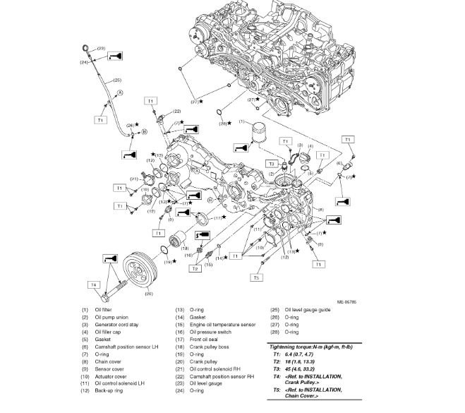

Chain Cover
REMOVAL

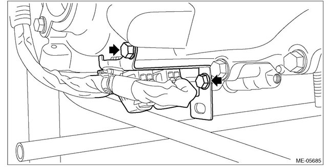

(3) Remove the bolts which secure the generator cord stay to the chain cover.

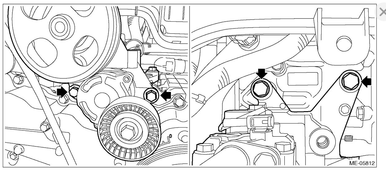

1. Remove the V-belts.
2. Remove the generator.

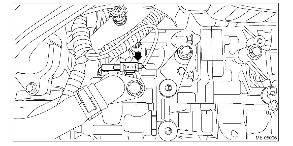

3. Disconnect the connector from power steering pump switch.
4. Remove the power steering pump from the engine.
5. Place the power steering pump on the right side wheel apron.

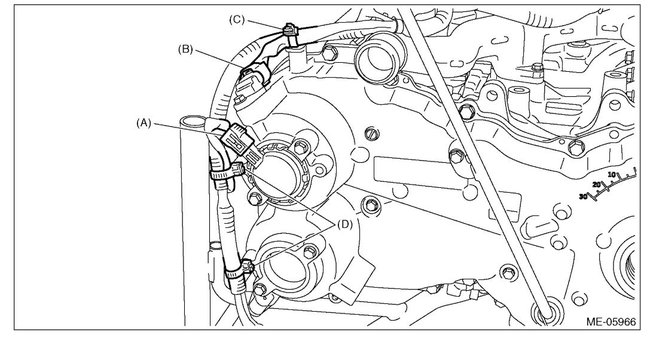

6) Disconnect the connector (A) from the oil control solenoid RH, and the connector (B) from the camshaft position sensor RH, and remove the clip (C) and clip (D) which secure the engine harness.

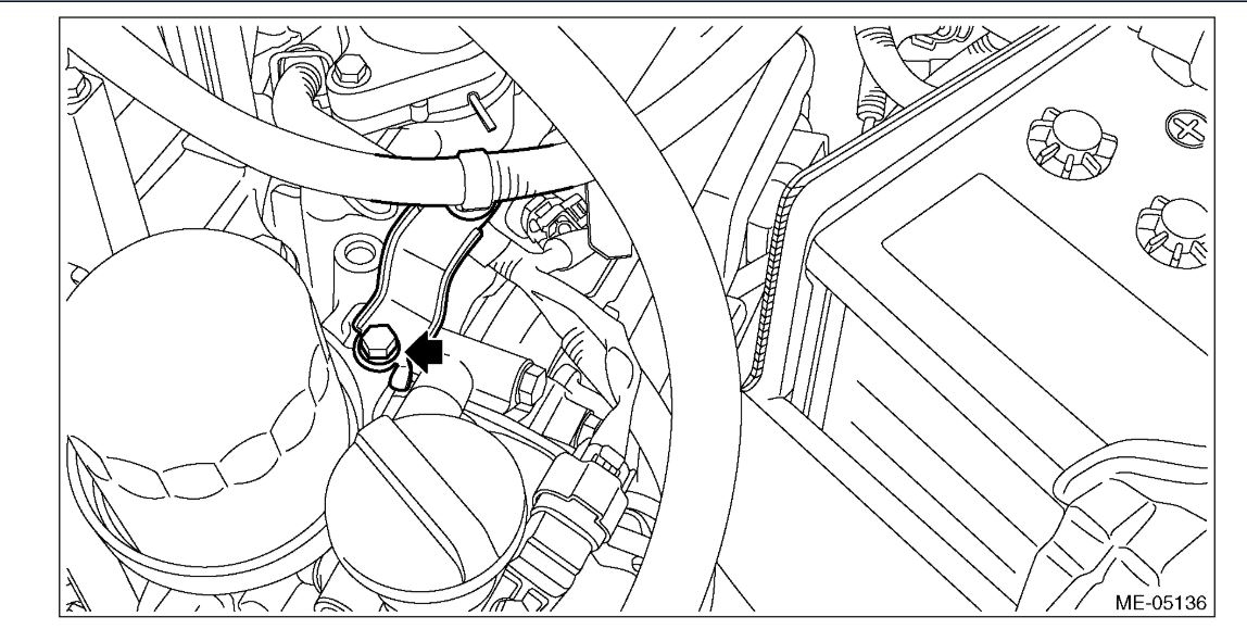

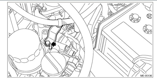

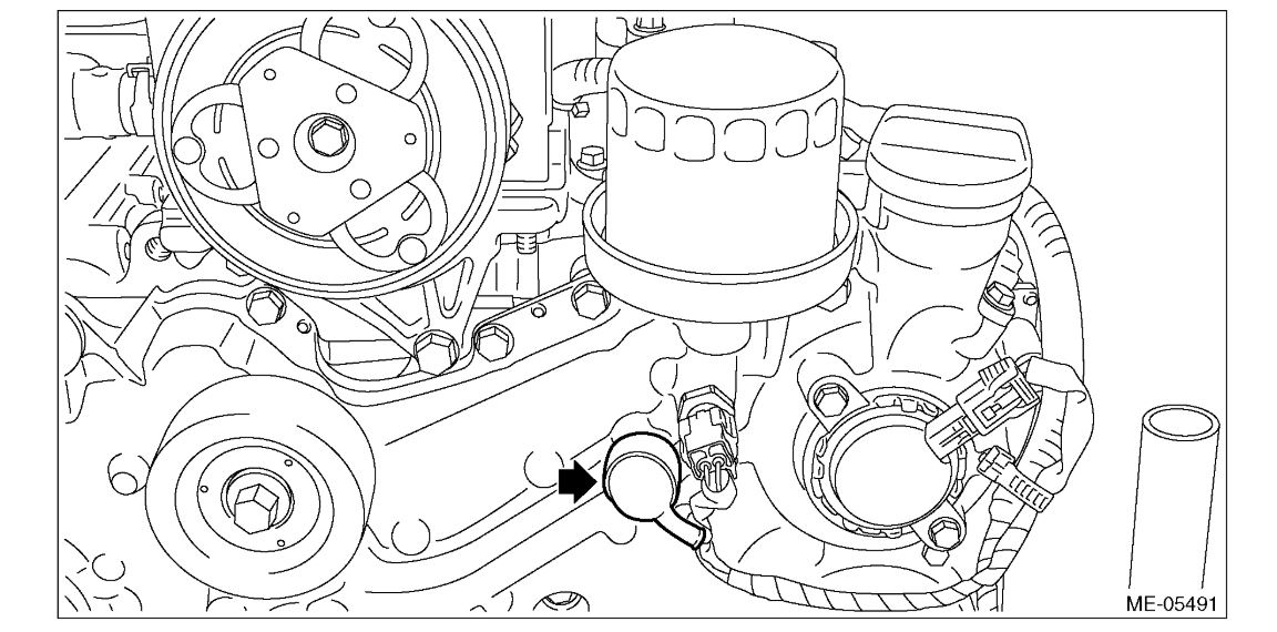

7) Remove the rubber cap from the oil pressure switch.

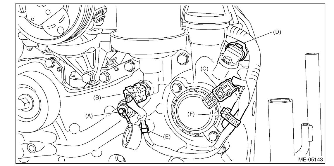

8) Disconnect the terminal (A) from the oil pressure switch, and connector (B) from the engine oil temperature sensor, and connector (C) from the oil control solenoid LH, and connector (D) from the camshaft position sensor LH, and remove the clip (E) and clip (F) which secure the engine harness.

10) Remove the chain cover.
11) Remove the O-rings from cylinder head RH, cylinder head LH, cylinder block LH and oil pan upper.

Thank you for your reply. Were all those removal steps you listed whats involved to fix the gasket leak? How much (ball park) would it cost to have the gasket replaced?
Jul 6, 2020 at 12:24 PM
Yes, that was the removal process.
As far as price, the book pays around 6 hours. That would be around $625.00 to $650.00 in labor plus about $40.00 in parts.
