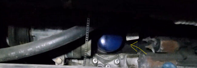

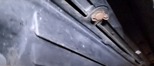

If you locate your A/C Compressor it will be right behind it on the side of the motor. There is an access panel under the radiator held on by 2 nuts. If you remove this access panel and look up at the side of the motor, you will be able to see it between the A/C Compressor and Starter.
I have added a couple pics for your reference.
