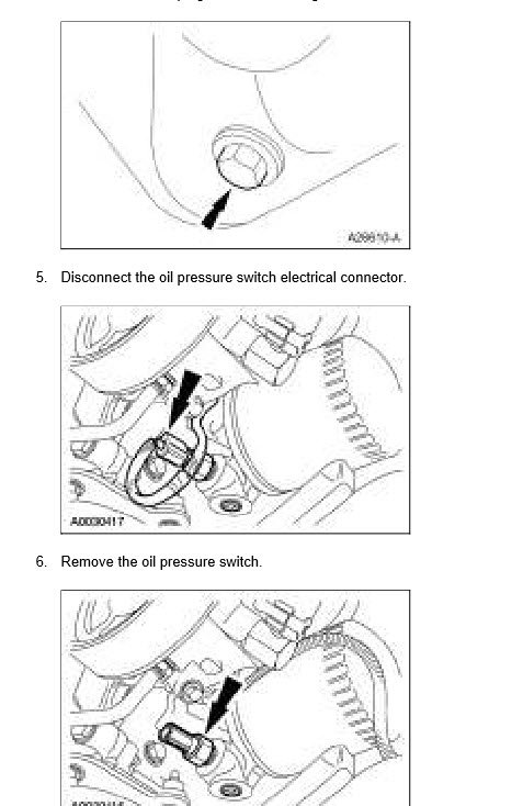

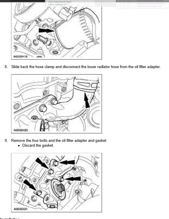

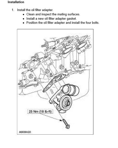

How do you change gasket on the Oil Filter Adapter?
May 2, 2016 at 8:35 AM
HMAC300
  • 48,601 POSTS
drain oil and coolant first disconnect hose by filter, jack engine up and remove lh motor mount then follow pics. Check out the diagrams (Below). Please let us know if you need anything else to get the problem fixed.
