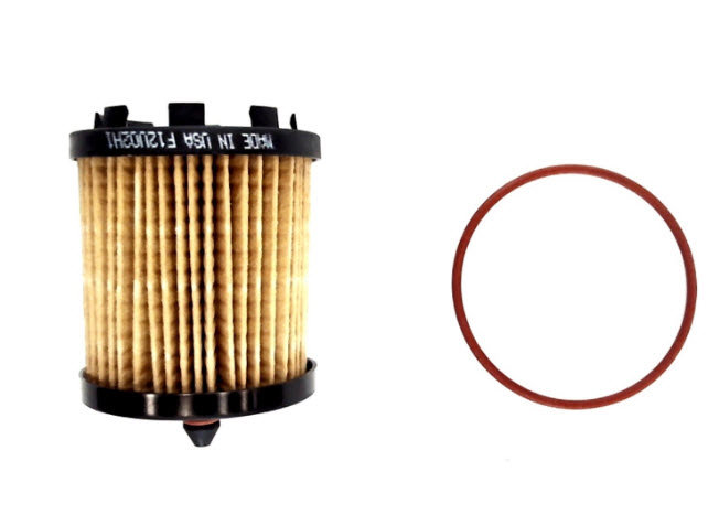

I watched your video on YouTube entitled 'Oil Change and Filter Replacement Chevrolet Cruze 2008-2015.'
I have a Captiva and that is the exact oil filter that I need. Unfortunately I cannot seem to get it anywhere else apart from my dealer.
Can you direct me to site where I can get that filter cartridge?

if this is what it looks like in picture the numbers for Purolator L15436, AC Delco PF457G, and Wix 57082 . Wix makes Napa filters so they have a cross reference for these. If you use synthetic oil then there is another that Wix makes for that if you want it. I would recommend synthetic oil due to having a turbo on this engine.
