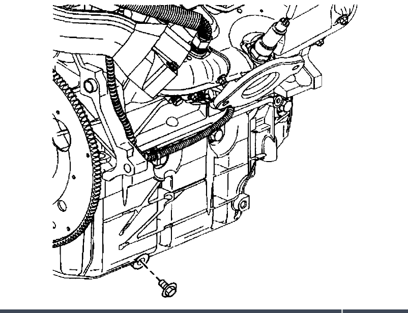

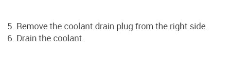

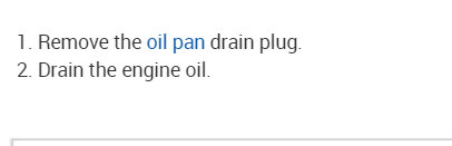

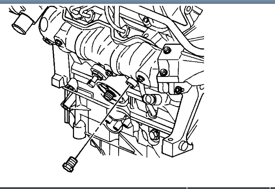

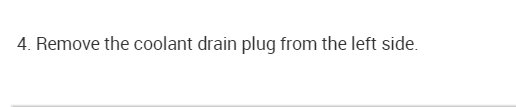

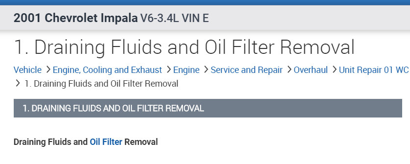

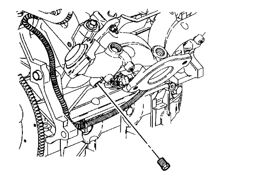

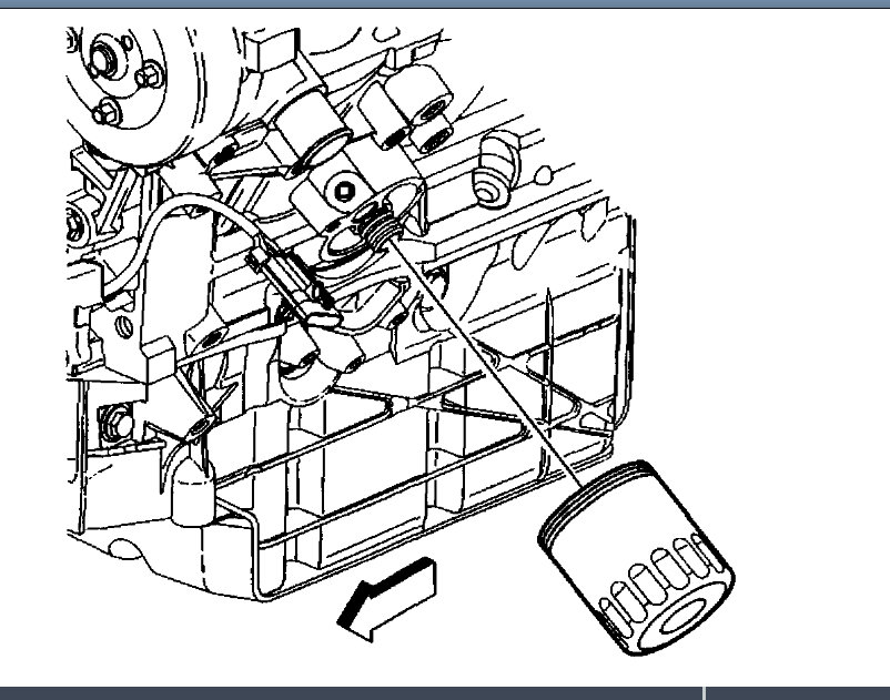

where is it the oil filter?

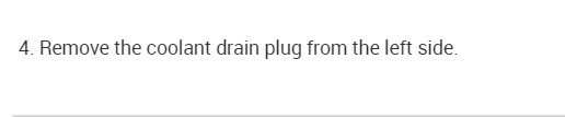

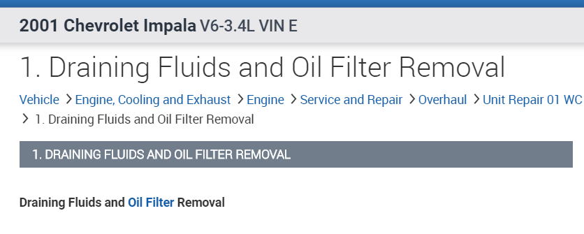

I have included the information that you have requested in the diagrams down below. If you should have any other vehicle related questions, please, feel free to ask. It's why we are here.
