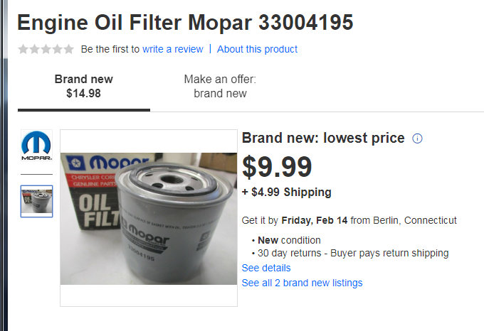

I went to change oil in my vehicle and can't find a filter to fit it. they are all too small. tried all different brands same thing. i even matched the number and brand that i removed and it is too big.

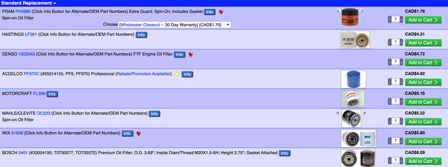

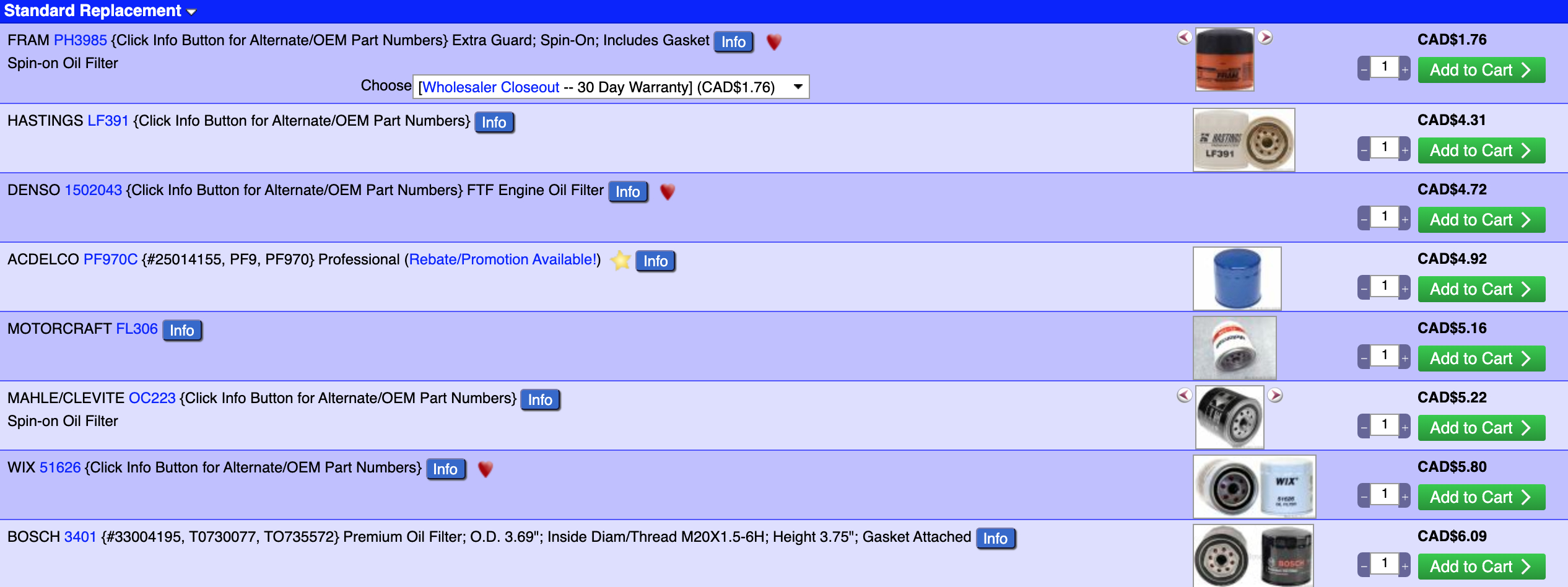

The original Jeep part number for your vehicle should be 33004195
I have attached a picture from rockauto.com showing some of the cross over parts options.
The size of the body of the filter is not necessarily a problem as it varies with different brands and even with the same brand over time.
What you do need to do is to ensure that the threads on the filter match the filter housing and that the rubber seal on the filter is the same diameter.
Can you send us a picture of the part you removed?

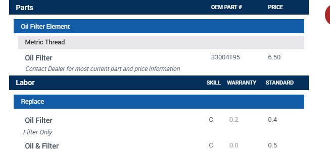

So there are a couple variables that are possible. It could be the engine is no longer a 2.5L. If this is the case then the filter is not going to be what came in from the factory. Another possible issue is someone put a different style filter on it that still fits. Not all companies build the filters to look exactly the same but they still fit the vehicle.
If you have a 2.5L engine in this 1990 YJ, then I attached the OEM part number and the picture of this filter. If the one on your vehicle looks like this one then which ever you are looking up is for a different engine.

Okay, i have solved it. there was a motor swap done going from a 1990 motor to a 1994 which was rebuilt different size oil filter. the 1994 filter fits perfect figures i got lucky the other 3 times i changed the oil. Many thanks everybody for your help.
