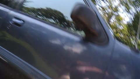

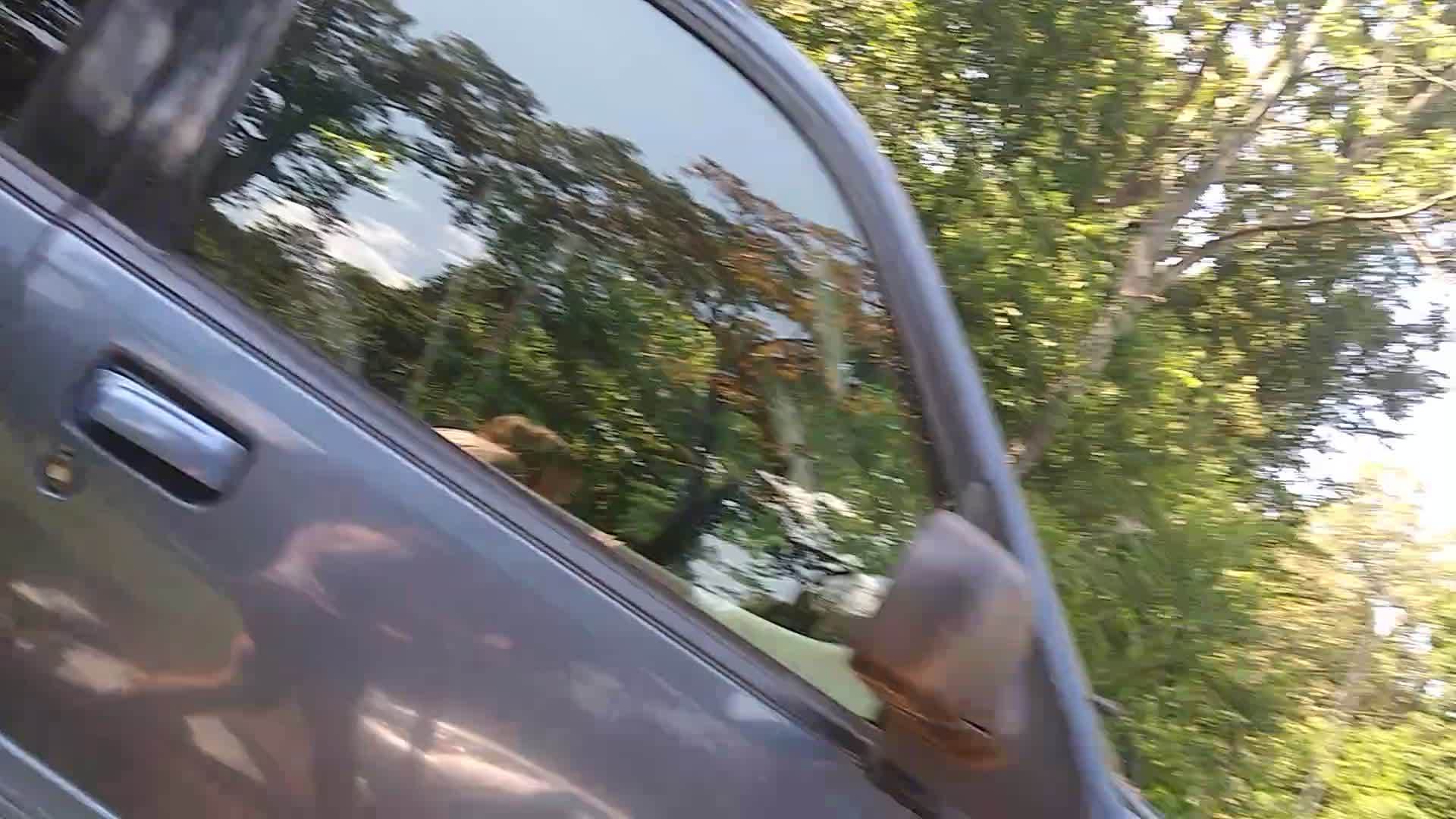

Here is the video:

Thanks. It sounds like the main bearings are locked up.
No way to get any more time out of it.
