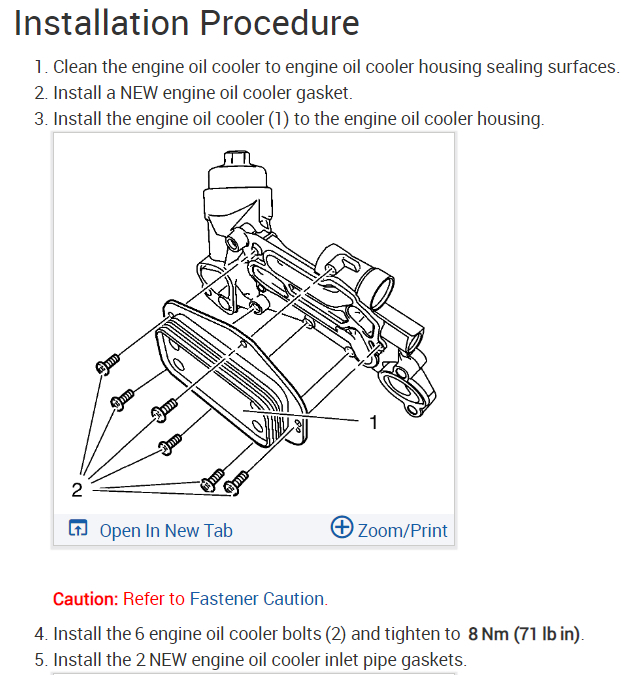

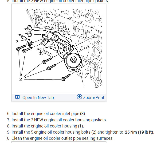

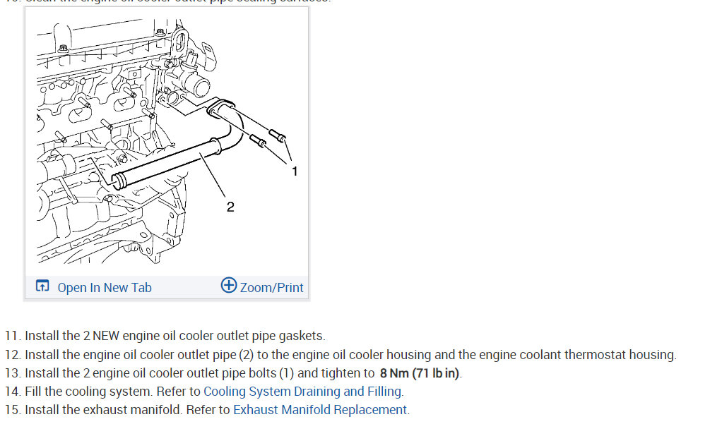

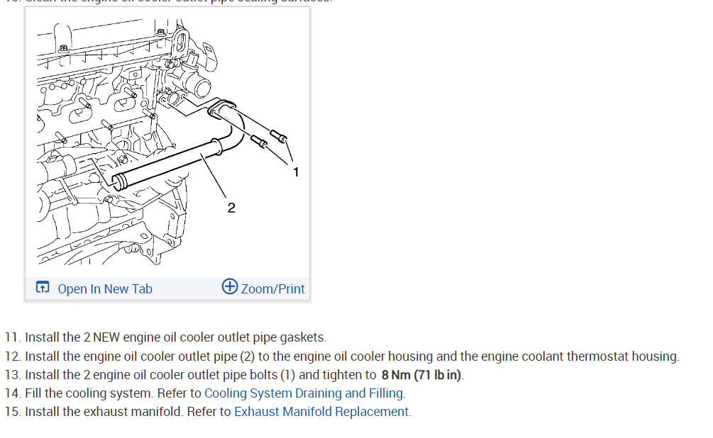

Replace oil cooler behind the exhaust manifold with diagram and torque settings for bolts.
Sep 16, 2024 at 2:53 AM
Experienced Mechanic
55,711 POSTS
Sure, here is the engine oil cooler replacement instructions with torque specs. Check out the images (below). Let us know if you need anything else.
