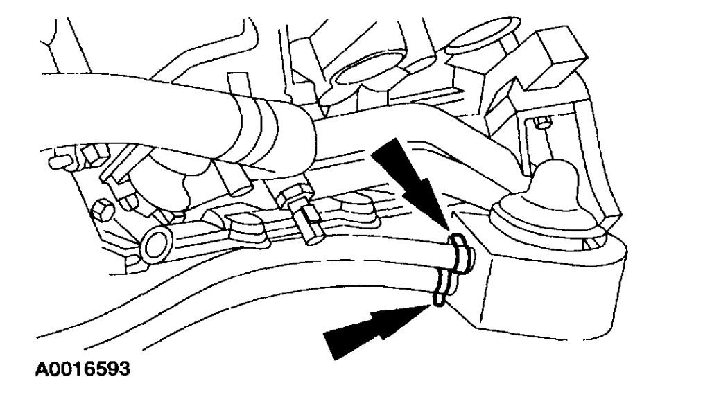

How to remove cooler under oil filter?

Good morning,
I attached the procedure and pictures for you.

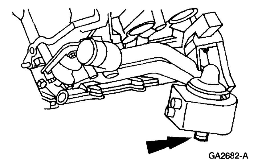

The bolt that holds the cooler to the motor is the threaded bolt that holds the oil filter to the housing. Inside the bolt is a allen head that you remove to remove the cooler.

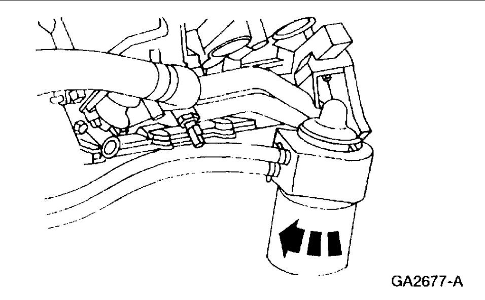

4. NOTE: Make sure all O-ring seals are in place.
Remove the oil filter.
ImageOpen In New TabZoom/Print
5. Slide the hose clamps down and disconnect the coolant hoses from the oil cooler.
6. Remove the oil cooler insert, and remove the oil cooler.

Do you know the allen size will hex socket work?
+2
Friday, July 31st, 2020 AT 5:09 AM
  • 52,797 POSTS
The socket is a 14 mm allen head socket. You can get it at any parts store.

When replacing cooler does it make a difference on the 2 hoses to cooler hook up top or bottom?
Tuesday, August 4th, 2020 AT 12:57 PM
  • 52,797 POSTS
Either way is good. The coolant just circulates through the cooler.
