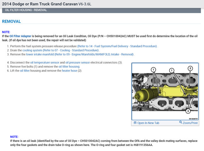

The oil cooler on my 2014 Dodge Grand Caravan had just been replaced because oil was leaking on the front end of the engine. As of now, everything is fine. I just want to see a picture of the said oil cooler, where is it located and what does it do. Thank you very much and hoping for your most appreciated reply.

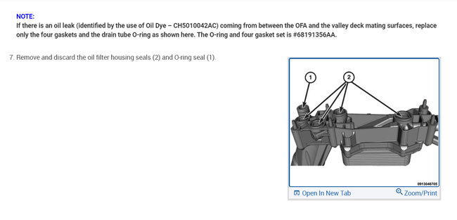

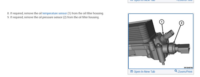

the oil cooler is under the intake manifold here is the location in the diagrams below.

So is this an engine oil cooler and what is the main reason why it leaked oil? I had 3 Dodge Grand Caravan in the past but I never had this issue. And does all vehicles (American, Japanese and European cars) had the same location? Thanks once again.

it could have broke or a rock hit it and punched a hole in it or an O ring bad in it. they are in various places due to manufacturer of vehicle.
