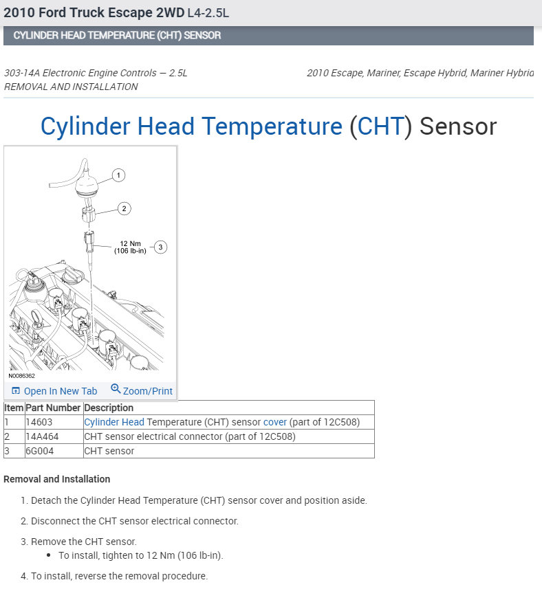

Temperature gauge on the dash heats up much faster than it has in the past. I have had the car for 2 or 3 years and it has never gone over to the right and maxed out the dash gauge. The last oil change was less than 100 miles, radiator coolant was filled up at the same time. Radiator has minor damage from a previous accident; however, it does not appear to be leaking. Gauge gets hot from both idling in a parking lot and driving on the road and highway. What I am looking for is more information on the subject and a diagram of my engine showing where the sensors that check the temperature are.

Typically, when the gauge shows above normal operating temperature, it is due to overheating of the engine.
So, does the engine overheat?
https://www.2carpros.com/articles/symptoms-of-an-overheating-engine
The engine can overheat due to a number of reasons. It could be due to a stuck closed thermostat, bad water pump, faulty radiator, in operative cooling fan. It can also overheat if there is any blockage in the cooling system.
Take a look at this guide, it covers the typical overheating issues:
https://www.2carpros.com/articles/engine-overheating-or-running-hot
Of course, it is possible to have a faulty sensor and not actually overheating engine.
The temperature sensor is located on the top of the engine.
I have attached a diagram for your reference.

Thank you so much for your quick response and the diagram with the included location and part number. If I have any other questions I will be sure to let you know.

You can check to see if the radiator fan comes on. Maybe after the vehicle has been running for a while and the engine is at operating temperature, open the hood (with the engine running), and see if the radiator fans are coming on.
Also, it is possible to have a faulty sensor and the engine might not be running hot or overheating, as you do not have the typical symptoms.
One way to know if it is overheating is by using an infrared thermometer and check the temperature of the thermostat housing at the end of the radiator hose.
The operating temperature of this engine is 220F. If that temperature stays around this that it is a sensor or even a gauge issue.
If the temperature is noticeably higher than it is overheating.
