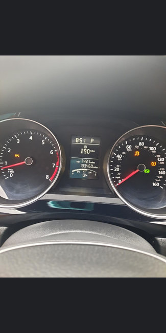

The car has been using a excessive amount of oil, dealer said it's burning oil, possibly the turbo or PCV. I've replaced the PCV. Oil continues to burn. Now the EPC light came on and the car went into limp mode. And I noticed there is a good amount of soot in the tailpipe. Are these problems related or am I having more than one problem?

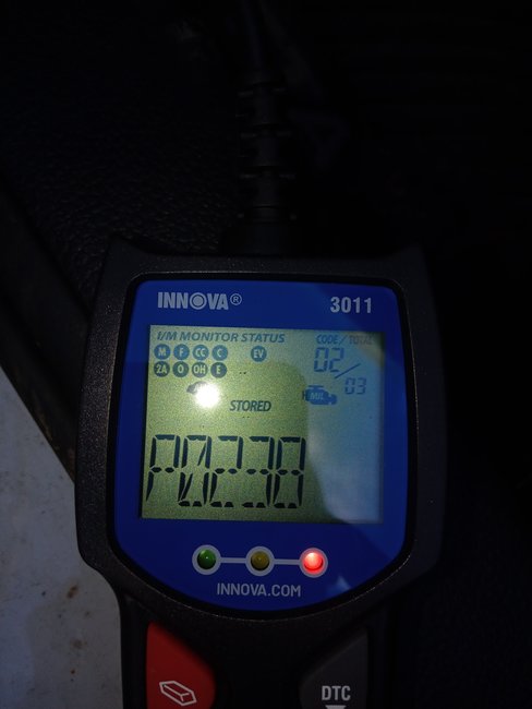

The two codes are p0301 and p0238.

The P0301 is an intermittent misfire on cylinder 1. The P0238 is a problem with the boost sensor which tells the PCM what to do with timing and fuel when the engine is running under boost. What are your wife's driving habits? Sort of putt around town and not really spirited driving? I would take it out for a good drive, get it up to temperature and drive it as hard as possible for 20 miles or more. Now see how it runs. Oil use could easily cause both of your codes as it will soot up the plugs and the carbon can plug the boost sensor as well.

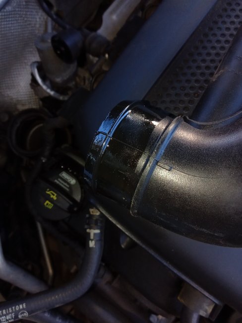

So far I've only had enough time to check the inlet hose. The inside of it was dry. Except at the end where it fits into the rubber (boot) I guess that goes into the turbo. Pic included. And there was a little bit of oil inside the part that connects to PCV. She drove it yesterday a little more than 100 miles. Didn't use any oil, drove it not nearly as much today and now it needs oil again.

Oil there isn't a good sign. You could buy one of the cheap endoscope/inspection cameras that plug into a phone and snake it into the turbo housing and see what the turbo looks like, if it's oily then you have the answer. With the mileage it has I would suspect it is due for a new turbo.

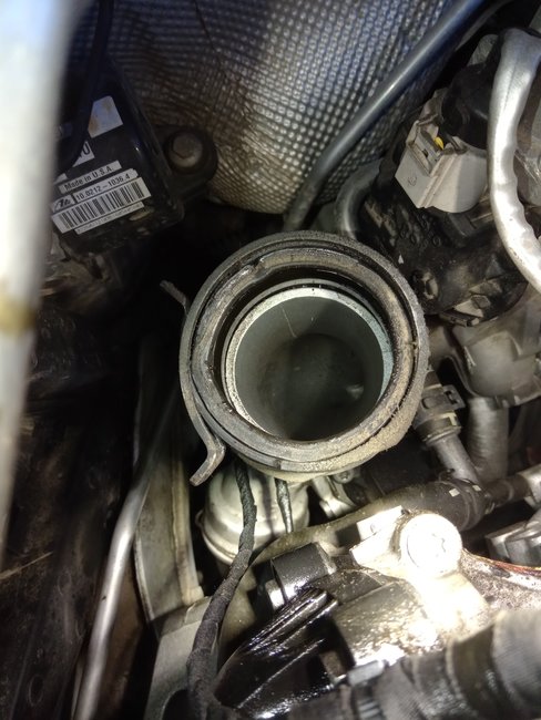

Well, I snapped this picture when I had the inlet hose off, I guess I need to see farther inside? Would getting a used be okay?

With that being the inlet side and the earlier image with oil on the other side I think you already have the answer. For a turbocharger I would opt for new or a reman unit. Used is a big shot in the dark as you don't know the actual service history of the car.
