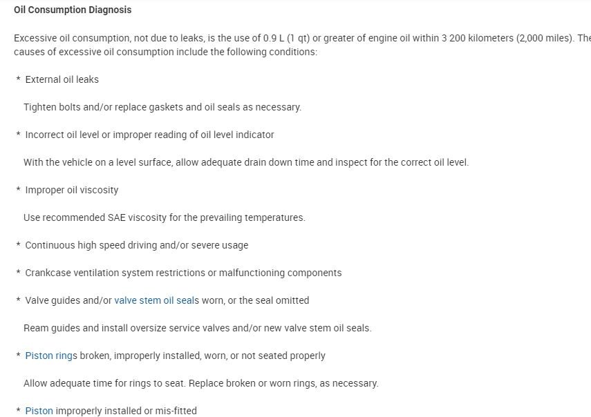

There is no additive that will help with consumption. The rings themselves may not be frozen but just worn out.
Normal oil consumption is a quart every 2,000 miles. That is just the manufacturers covering there butt.

There is nothing that really works well. You could try a top cylinder cleaning using seafoam or GM top cylinder cleaner. It is used to remove carbon from the combustion chamber but it could help clean carbon out of the rings. There are a lot of videos on the process out there. One big warning, it creates a huge amount of smoke and can blow a lot of junk out the exhaust.
The other option would be to drop a re-manufactured engine into it. Or buy a used engine and go through it before swapping it. There are you pull it yards where you can buy engines for 100 to 200 dollars that run fine.
GM should be required to replace all of them but it isn't considered a safety issue so they won't.
