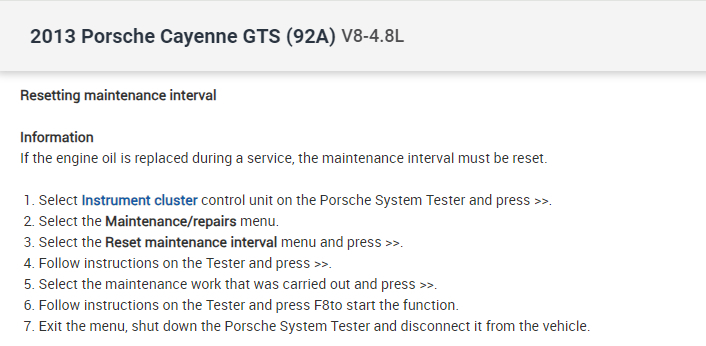

can I reset the oil change without a scan tool?

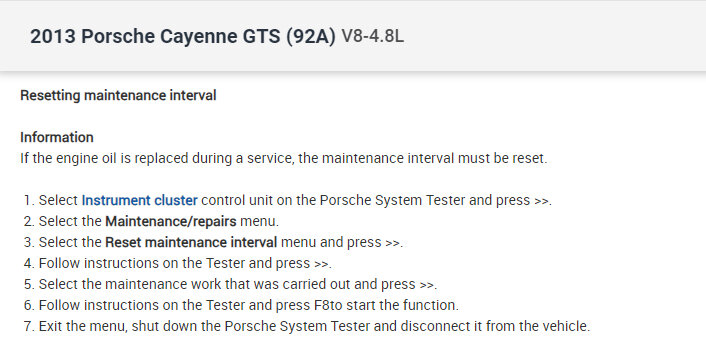

To the best of my knowledge, no. It requires a scanner or program that can communicate with the cluster module.
I attached what I have in my manual. Note there is nothing indicating to do this without diagnostic equipment.
I wish I had better news. Let me know if this helps.
See pic below.
