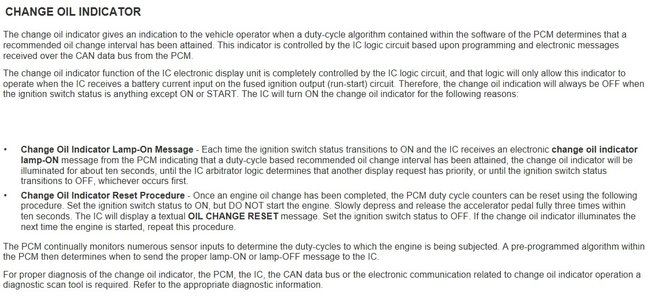

I had the oil change due message on the dash. I changed oil and filter. Googled how to delete message, it said press ignition button twice without starting car and depress accelerator pedal three times in ten seconds then switch ignition off to remove message, but it has not going out. Steve

Did you try pressing button only once, for on position? The rest of my information is the same as yours. My information did not say to press twice? I found this information in a tune-up manual, 07--016. It was under the heading of Chrysler, did not specify your model.

I found this information in my database for your year--make--model. Hope it helps.

I am having no luck with the procedure at all.

Sorry, You will probably need a diagnostic scanner that can communicate with instrument cluster--pcm--data lines?
