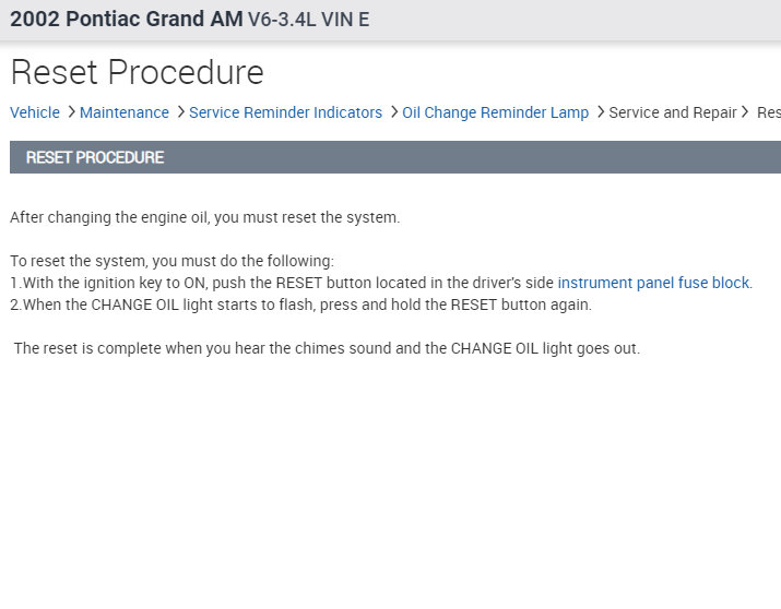

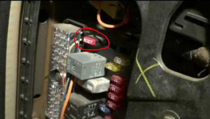

The oil light gets reset by pressing the reset button that is located on the fuse box, on the left side of the dash. See attached picture.
Simply turn the key to the on position and press the button.
Let me know if you have able to locate it.
https://www.2carpros.com/articles/oil-life-reset
